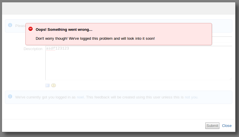

When creating an issue through the Issue Collector, the process becomes unresponsive and the following exception will appear on the screen:

The cause of this problem is due to the configuration of the Workflow's Validators, whereby the user does not have the a specific permission on the Workflow's Validator. To replicate this problem:
  1. Login to JIRA as a user so that the issue collector form will not ask for the name and email. For simplicity sake, the username will be USER1.
  2. Configure the project's workflow and add a validator that USER1 does not have the permission to execute
  3. Assign this workflow to the project that uses this issue collector.
  4. Create an issue through the issue collector and the process will throw an error similar to the above screenshot.
Resolution
Check the workflow's validator on the Create Issue Transition (for the project that uses the Issue Collector) and remove unnecessary validator that would prevent a login user to create an issue.
