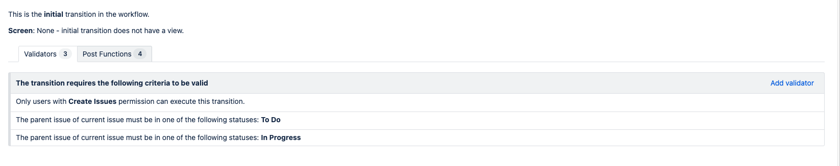

This scenario is observed when there is more than one validator configured for the parent status i.e. two or more unique validators are added to validate the parent issue status.

  • Navigate to the validator configured for the Create step.
  • There will be more than one validator configured for validating the parent issue status.

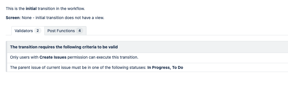

  • Please ensure that only one validator is added and remove the redundant validators for parent status. If multiple status need to be selected, it can be done using a single validator and selecting multiple options from the list. This will ensure that transition is successfully performed if parent is in one of the selected status from the list.
  • Publish the workflow and the subtask should now be created successfully.
