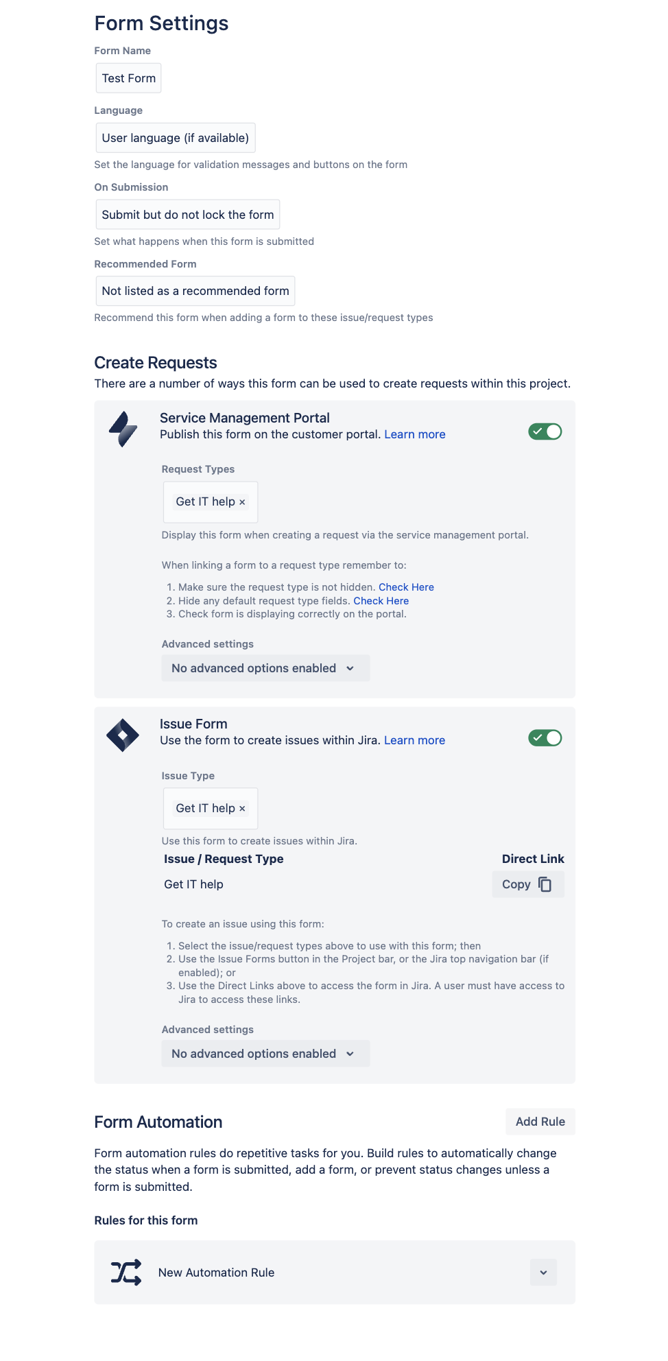

  • The Proforma form is configured with an automation rule:

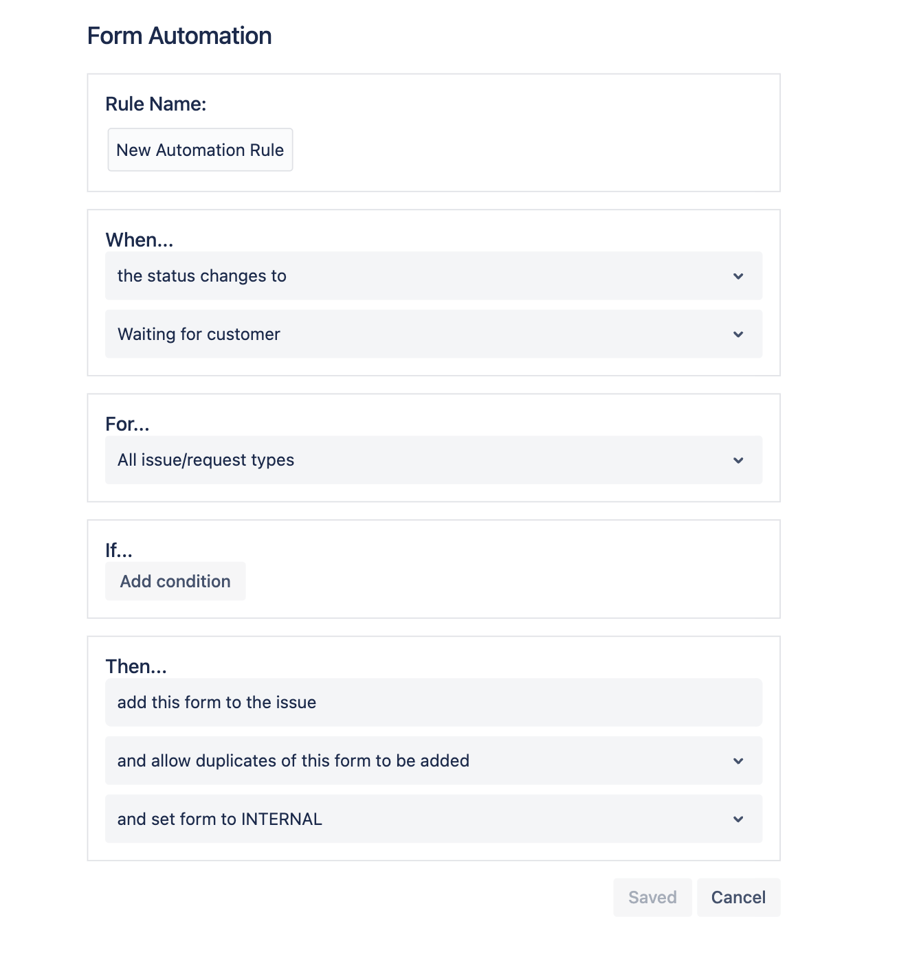

  • The rule is configured to be triggered when the issue is transitioned to a specific status ("Waiting for customer", in the example below):

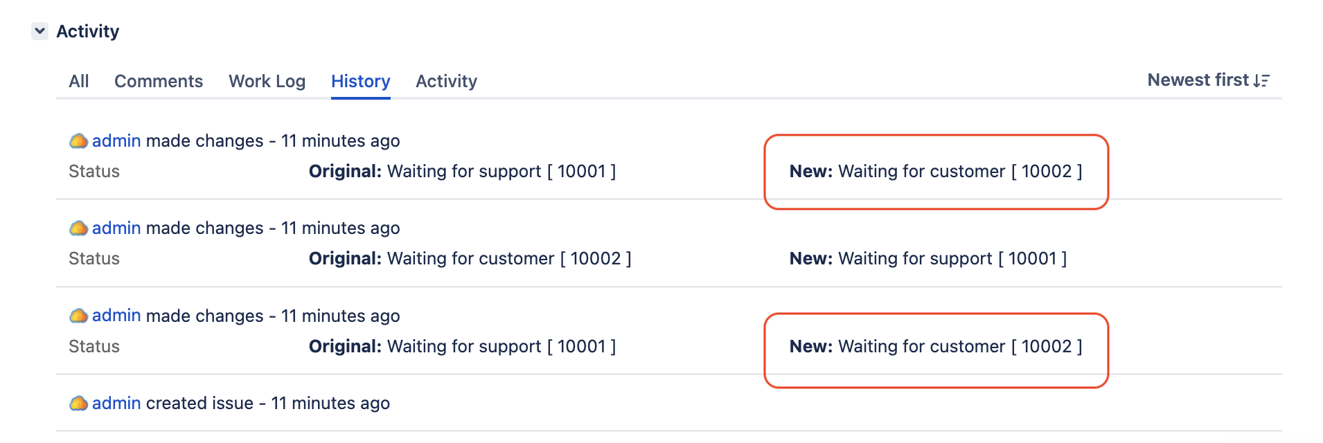

  • Checking the history tab of the JSM issue, we can see that it was transitioned several times to that status:

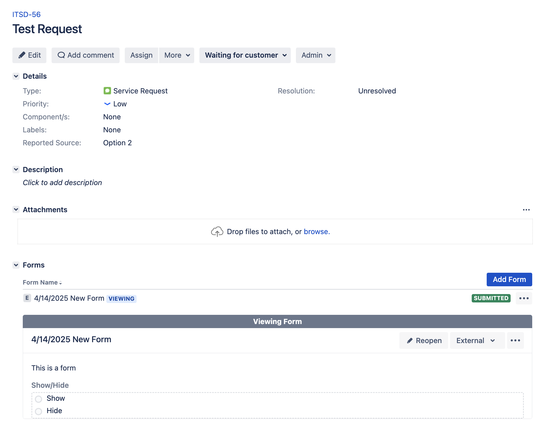

  • Checking the forms tab of the JSM issue, we can see that only 1 form is attached to it, and this form was attached at the issue creation time not when the issue was transitioned:

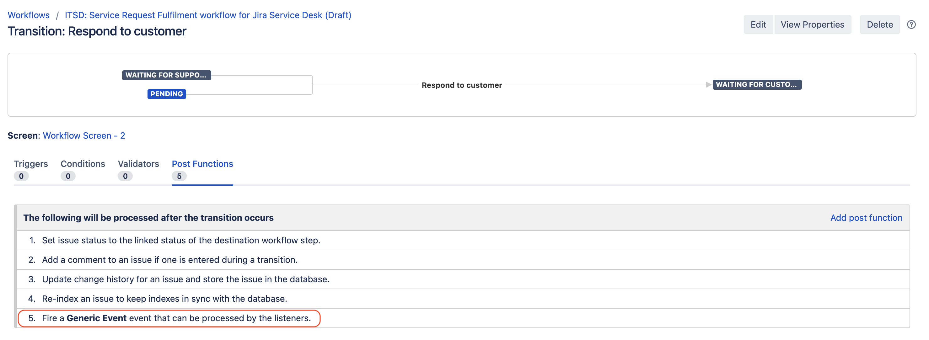

  • Checking the post-functions from the workflow transition that links to the destination status, we can see that an event which is not the Generic Event is fired:

Modify the post-functions in the workflow transition, so that the Generic Event is fired by the transition:
