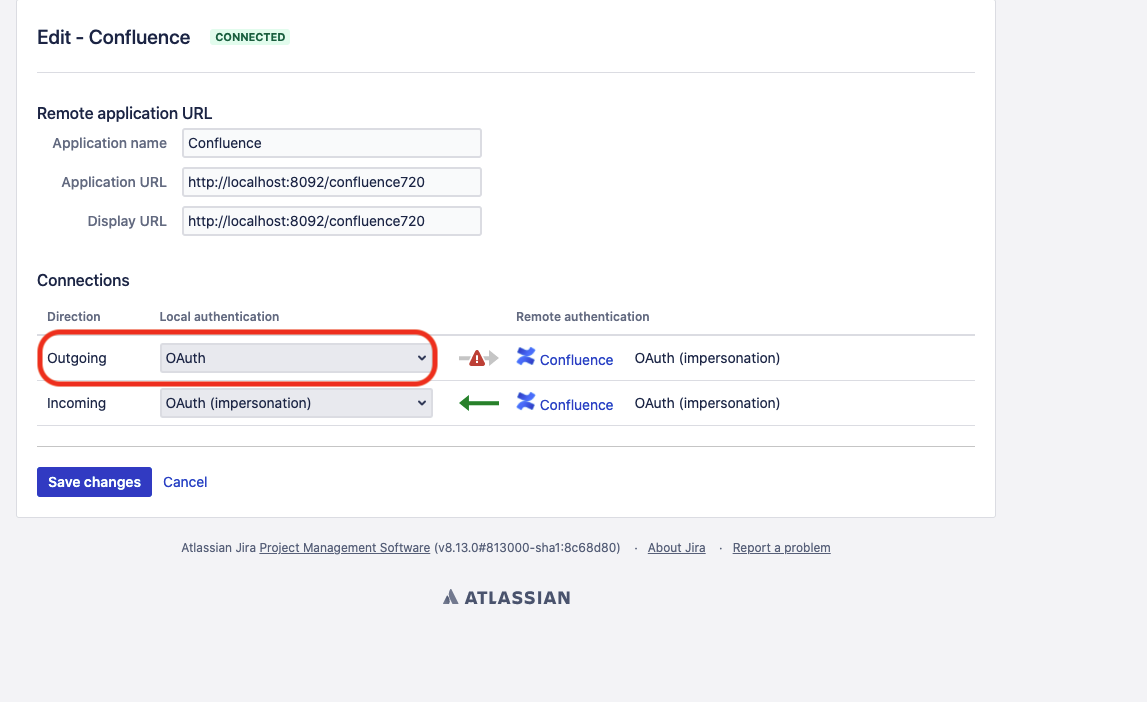

Go to the Application Links configuration page in Jira and also in Confluence. If either incoming or outgoing request is configured without "Oauth (impersonation)" either on Jira or Confluence side, then this root cause is relevant:

Root Cause 2 - The application link is not configured with "impersonation" for both incoming and outgoing
For the knowledge base search to work from the Customer Portal, it is necessary that the application link configured between Jira and Confluence used "OAuth (impersonation)" for both incoming and outgoing requests, and on both Jira and Confluence side. If these conditions are not met, then the Knowledge Base search will not show any result, unless Confluence is configured with anonymous access on both the application and the space levels.

Solution for Root Cause 2
Make sure that application link configured between Jira and Confluence used "OAuth (impersonation)" for both incoming and outgoing requests, and on both Jira and Confluence side
