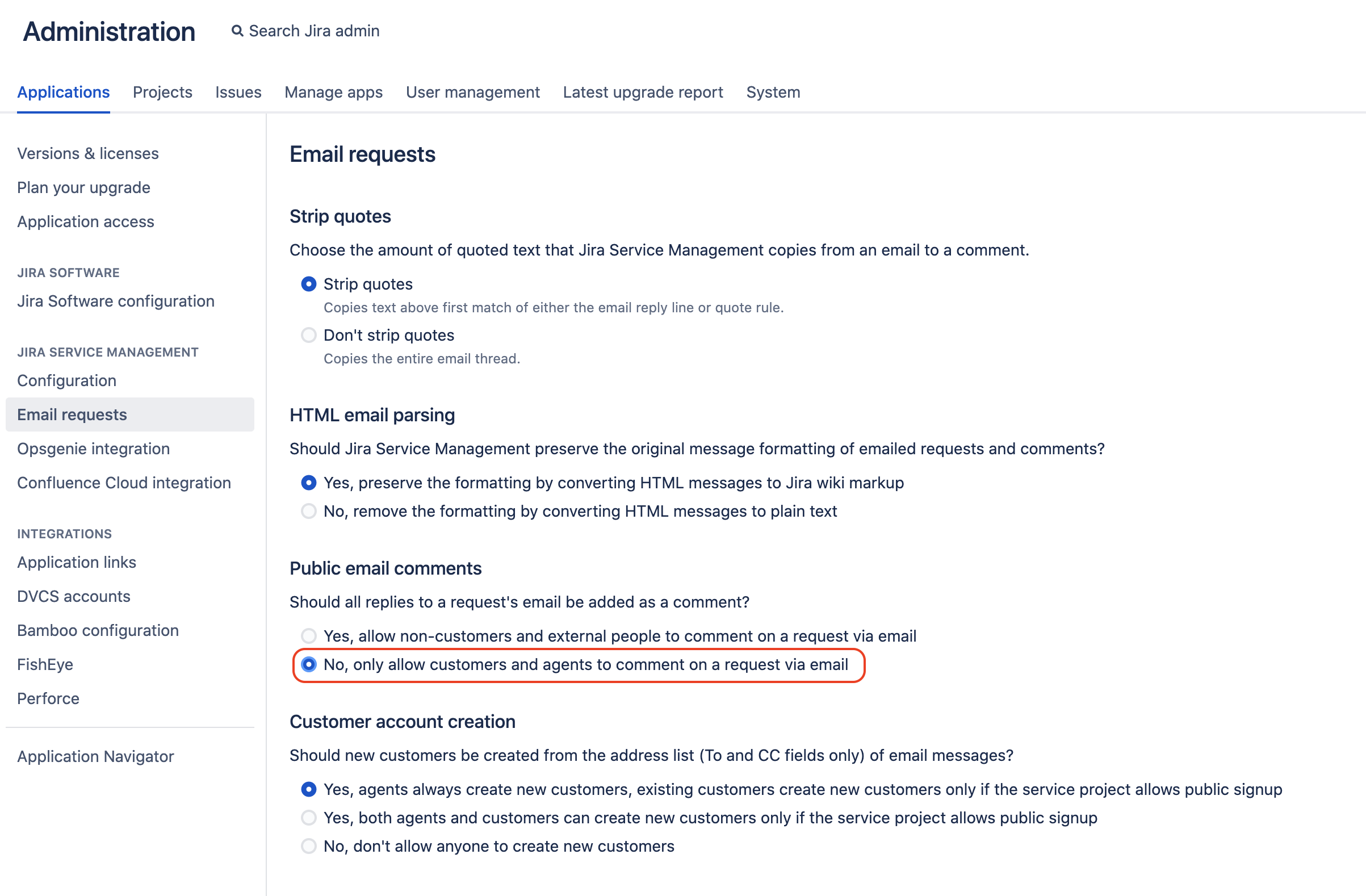

If the sender of the email does not have access to the Customer Portal (or does not have a Jira account at all), go to the page ⚙ > Applications > Jira Service Management > Email Requests and check if the setting Public email comments is set to No as shown in the screenshot below:
If the Public email comments is set to No, then the Root Cause 1 is relevant and you can move on to the Solution for Root Cause 1 section.

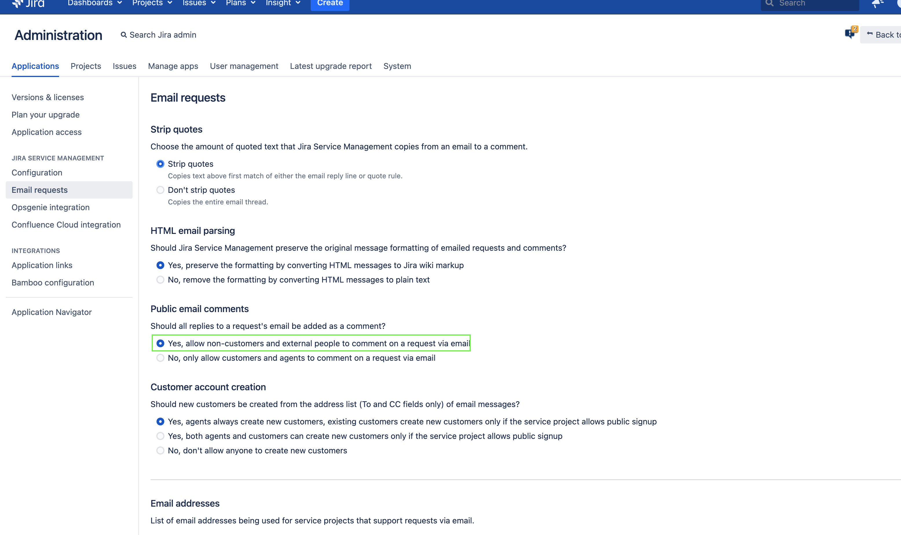

To fix the issue, you will need to allow non-customers (external users) to add comments by email to requests they don't have access to.
To do this, go to ⚙ > Applications > Jira Service Management > Email Requests and set the Public email comments setting to Yes as shown in the screenshot below:
⚠️ Important note: These configurations are global and the changes made will take effect on all JSM projects so please be informed.
