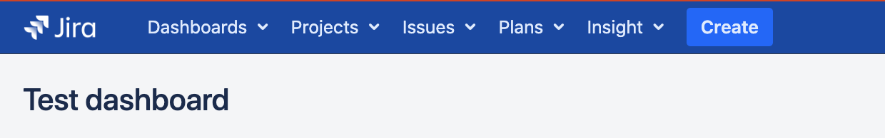

The board tab which comes from Jira Software has gone missing:

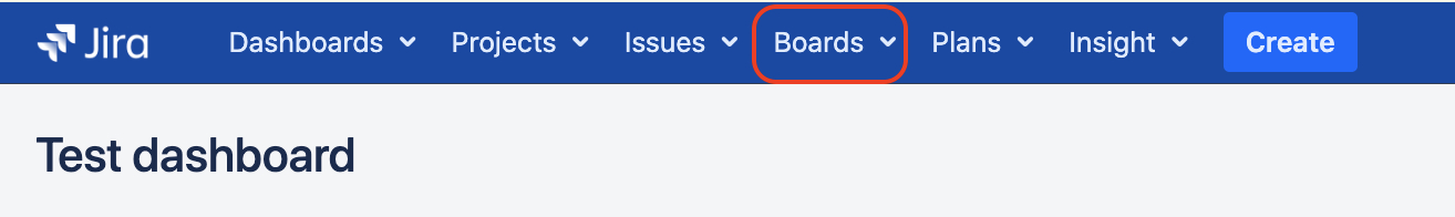

Normally, the board tab should be showing in the top bar menu, as shown in the screenshot below:

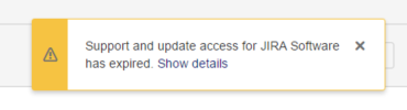

  5. Expired license. An expired Jira Software License has limited access towards Agile functionality:

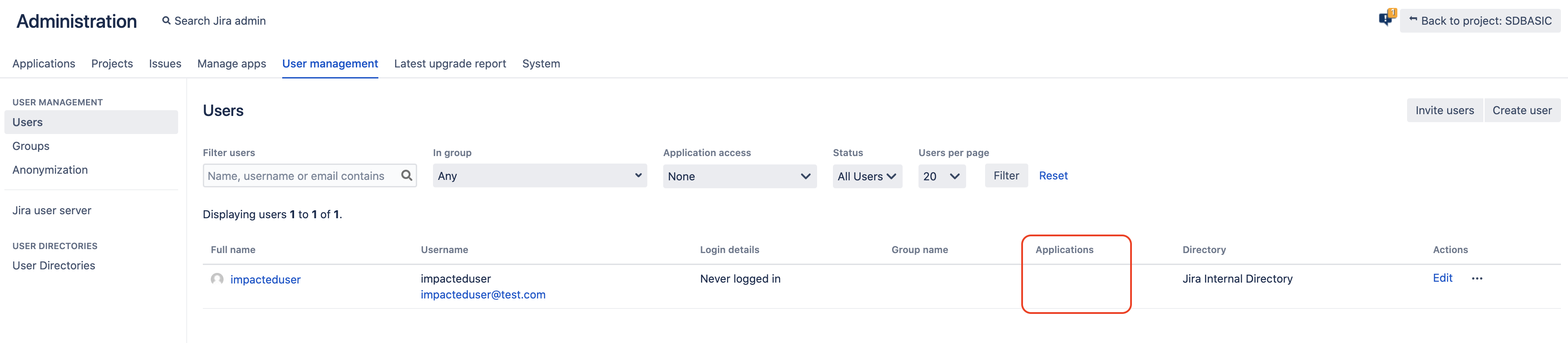

  1. Login in to Jira with any user that has Jira Administrator global permission.
  2. Navigate to ⚙ > User Management > Users.
  3. Look the impacted user in this page, and check if the Jira Software application is missing from the Applications column for this user, as shown in the screenshot below. If that's the case, then this root cause is relevant:
  4. In this case, you will need to add the user to a group which grants them Jira Software application, as shown in the page ⚙ > Applications > Application Access.

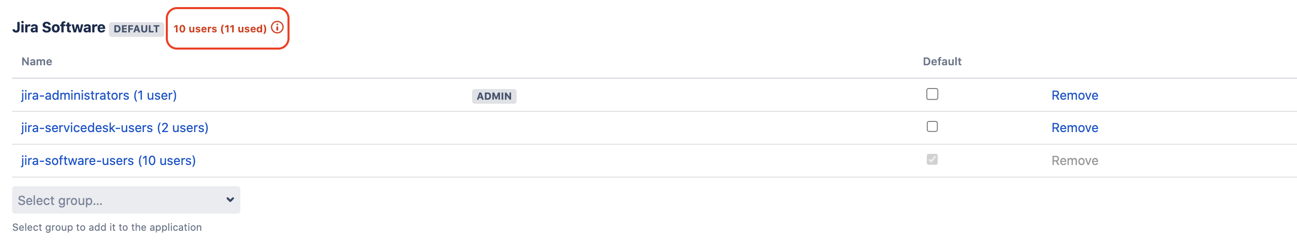

  2. Navigate to ⚙ > Applications > Versions & Licenses.
  3. Check if the used number is higher than the users number.
  4. If it is higher as shown in the screenshot below, then this root cause is relevant:
  5. In this case, you will need to either upgrade the Jira Software license to the next user tier, or remove licenses from users who no longer need it.

Cause 5
Renew the Jira Software License.
