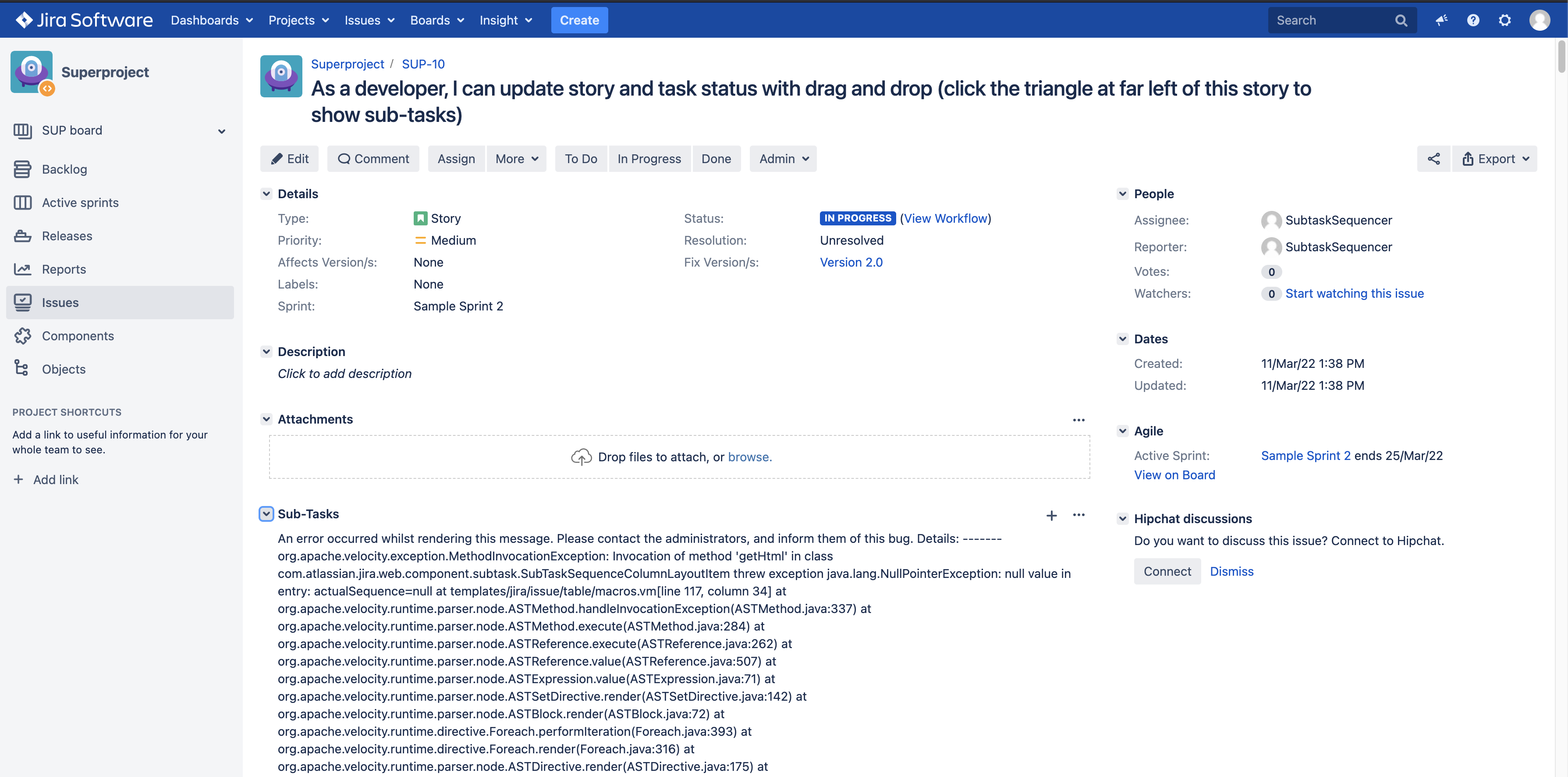

❌ Subtasks don't show, and there is an error/stack trace instead:
Subtasks don't display (sequence null)

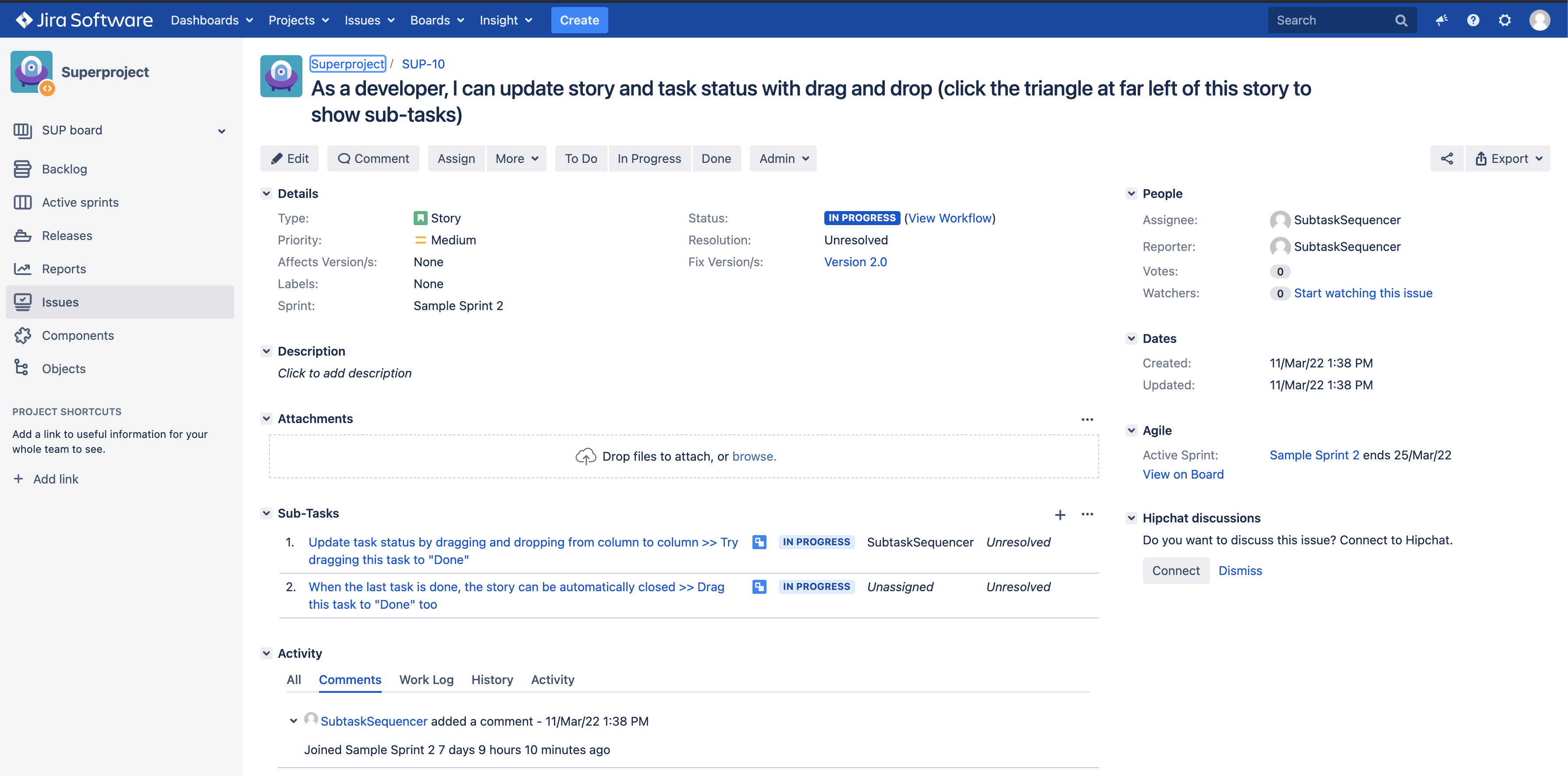

✔️ Subtasks should show up in a numbered list:
Error message in the subtask panel (excerpt)
An error occurred whilst rendering this message. Please contact the administrators, and inform them of this bug. Details: ------- org.apache.velocity.exception.MethodInvocationException: Invocation of method 'getHtml' in class com.atlassian.jira.web.component.subtask.SubTaskSequenceColumnLayoutItem threw exception java.lang.NullPointerException: null value in entry: actualSequence=null at templates/jira/issue/table/macros.vm[line 117, column 34] at org.apache.velocity.runtime.parser.node.ASTMethod.handleInvocationException(ASTMethod.java:337) at org.apache.velocity.runtime.parser.node.ASTMethod.execute(ASTMethod.java:284) at ... com.atlassian.velocity.htmlsafe.introspection.UnboxingMethod.invoke(UnboxingMethod.java:28) at org.apache.velocity.runtime.parser.node.ASTMethod.execute(ASTMethod.java:270) ... 473 more

  3. Test the Issue page; the solution should take effect immediately.
