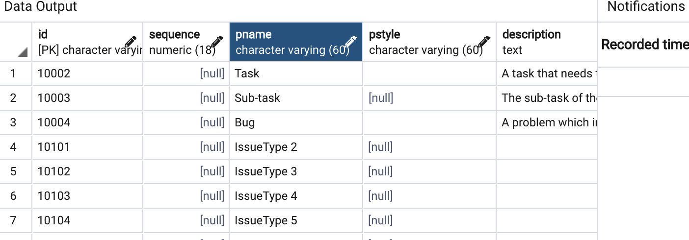

  • Check the database to confirm issue type details. Here is the result for
    select * from issuetype;
    Example result of pname column.
  • In this example the pstyle value for Sub-task is expected to be jira_subtask. However, it is set to null.

Below mentioned steps will help to recover from the situation:
  1. Capture the issueId by executing the query mentioned below:
    select id from issuetype where pname='sub-task';
  2. Execute below mentioned query to move the standard issue type to subtask issue type:
    update issuetype set pstyle='jira_subtask' where id='XXXXX';
    Note
    • Replace XXXX by ID captured in step 2
    • Update query is tested with PostgresSQL database
    • Make sure to take database backup before making any updates
  3. Commit the changes.
  4. Restart the instance for the changes to take affect.
