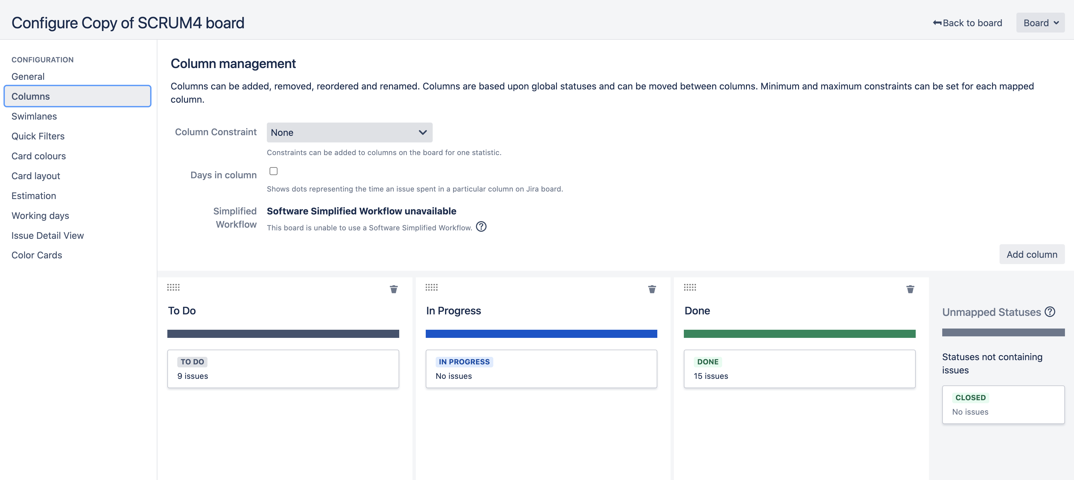

Let's create a new board, which is a copy of SCRUM4 and shares the same filter and column configuration, which are shown below:

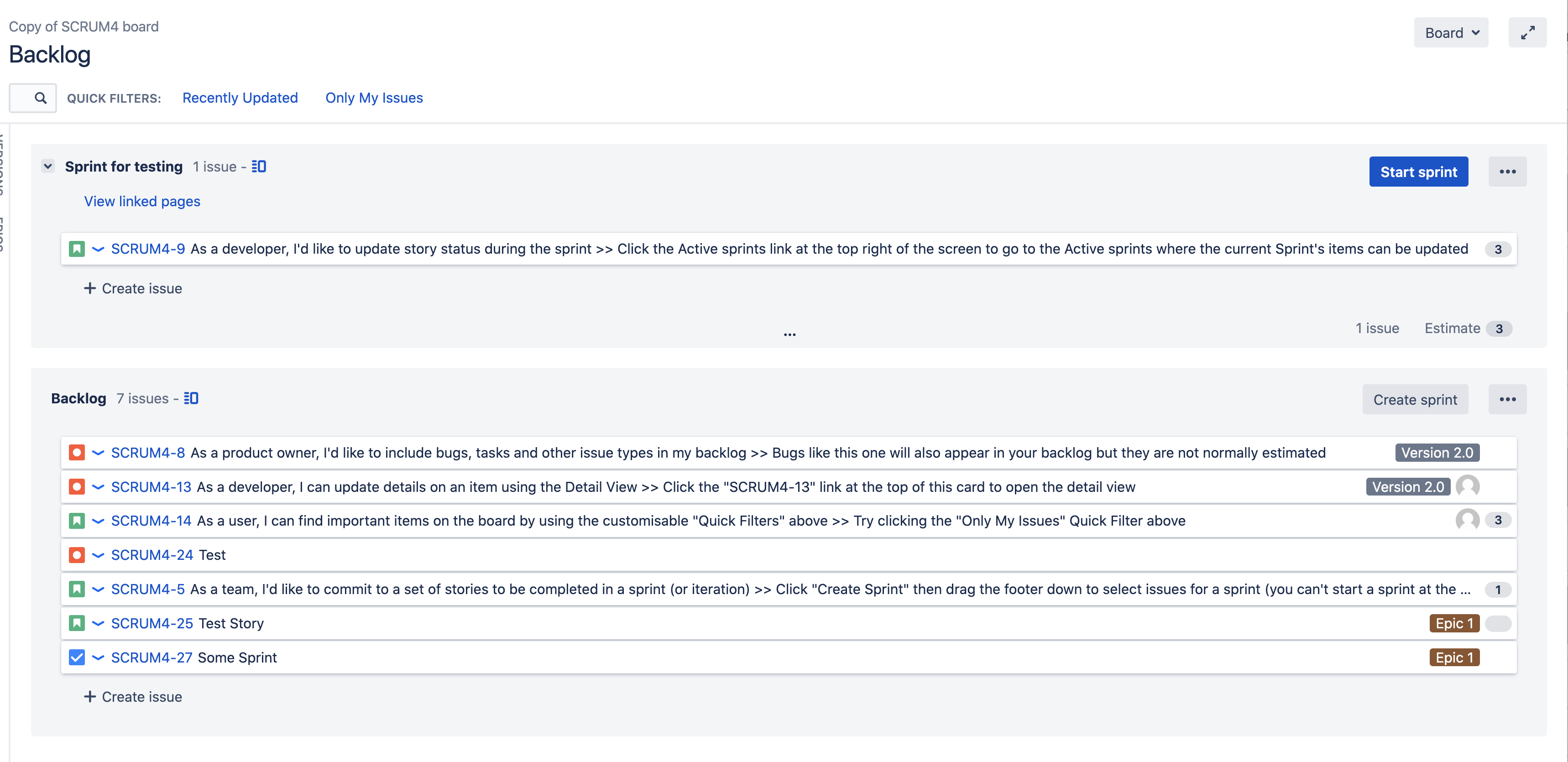

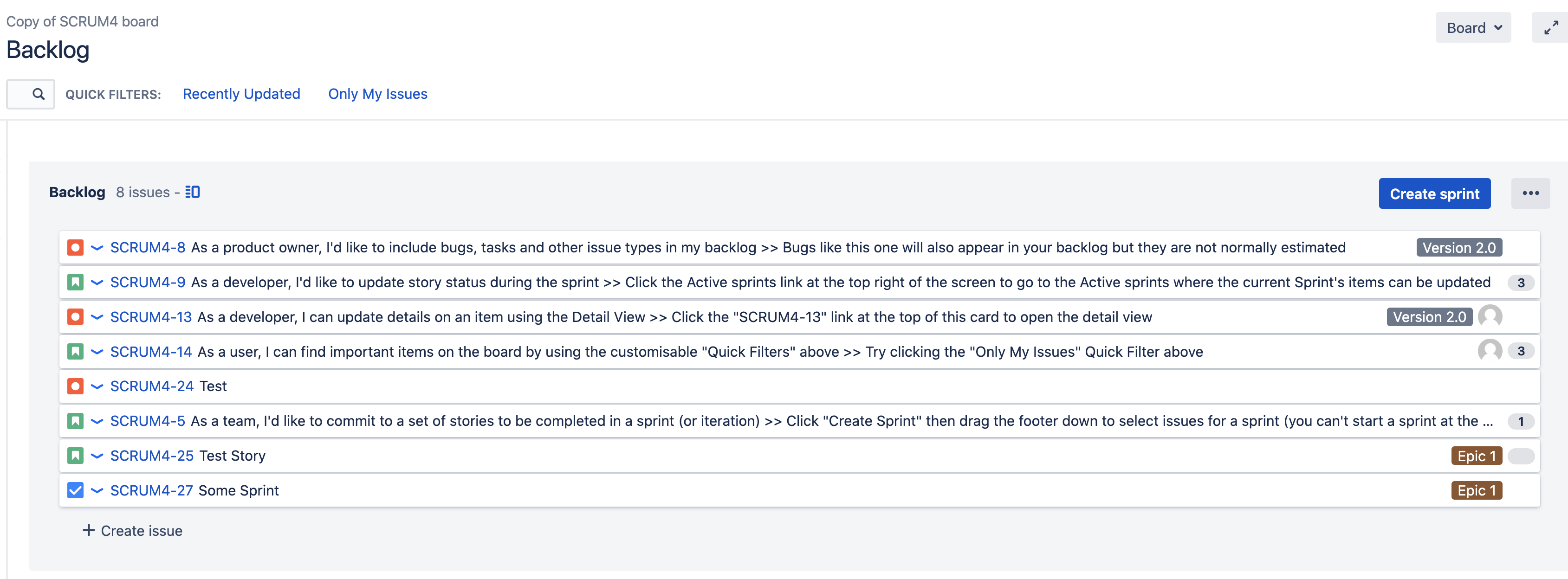

This board is called Copy of SCRUM4 board, and the Sprint is not showing (yet), because this board is not the origin board of the Sprint, and no issue has been added yet to the Sprint:

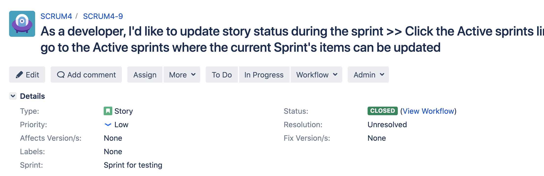

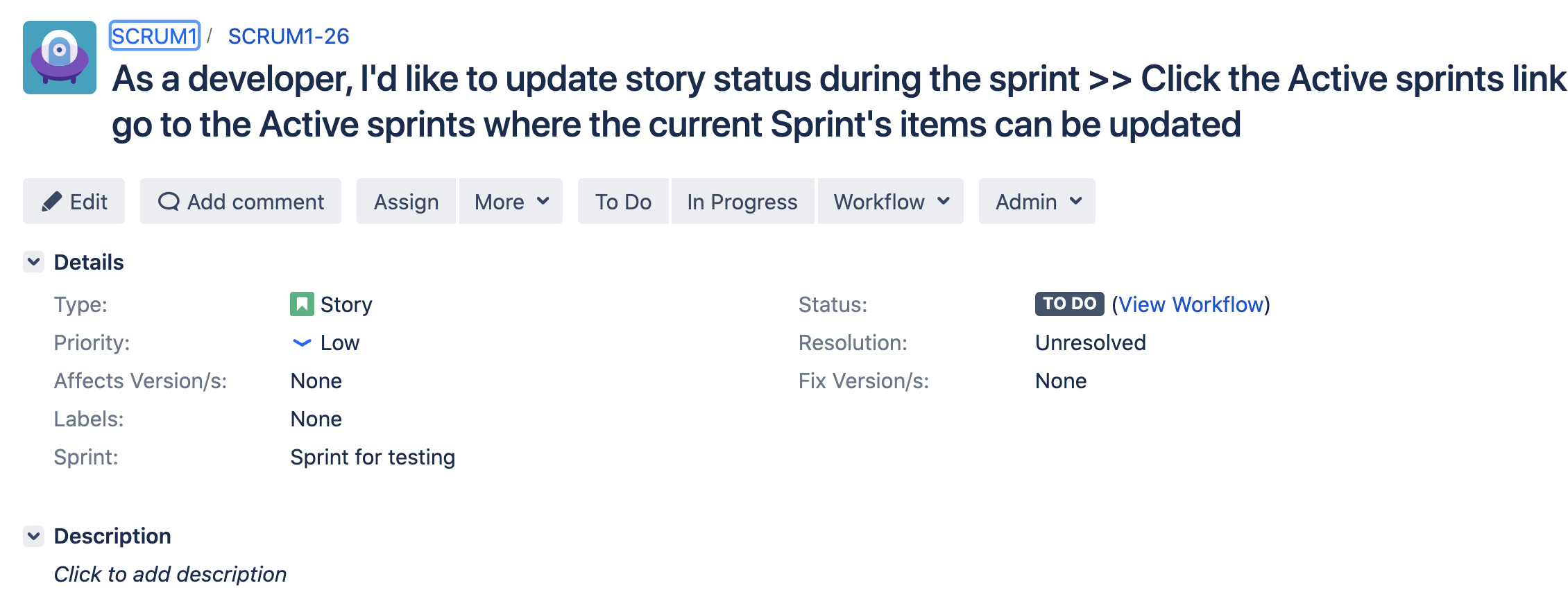

Let's add a new issue to the Sprint, which is in the To Do status, and which meets the board filter requirement (which uses the JQL query project in (SCRUM4)). In such case, the Sprint will show in the board Copy of SCRUM4 board, since this issue can be found by the board filter, and since this issue is in a status mapped to the To Do column:
If the issue is transitioned to either the status Done or Closed, the Sprint will disappear again from the board Copy of SCRUM4 board. That's because neither status is mapped to a column other than the Done column:
For the Closed status, it is not mapped to any column
For the Done status, it is mapped to the Done column

If the issue is edited in a way that it no longer verifies the filter query associated to the board Copy of SCRUM4 board, the Sprint will disappear from that board (regardless of the status the issue is in). In the example below, the issue was moved to a new project than SCRUM4, and is therefore no longer found by the board filter. This scenario corresponds to the Root Cause 2 listed in this KB article.

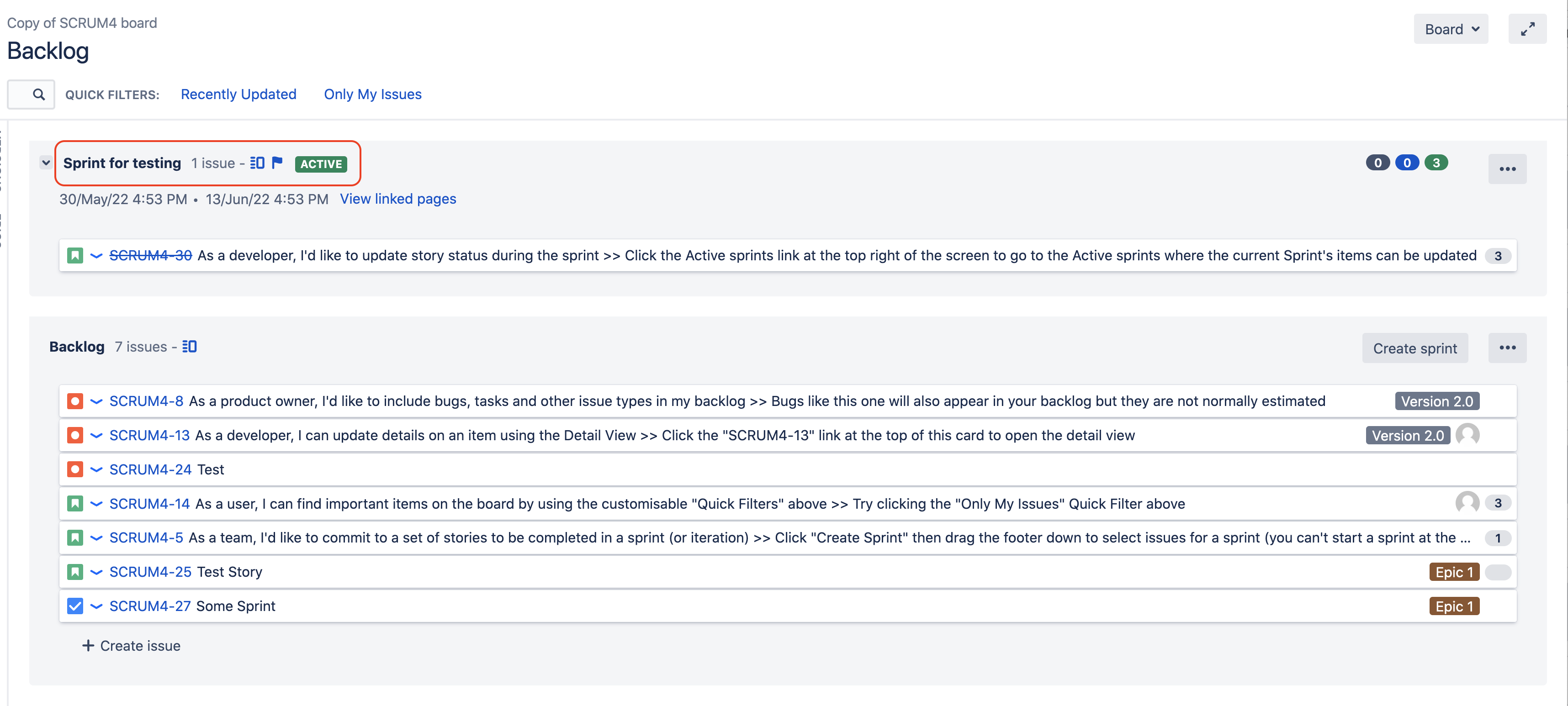

Note that, once the Sprint was started (and not completed yet), it will show in the board Copy of SCRUM4 board even if the issue is in a status that is not mapped to a column other than the Done column:

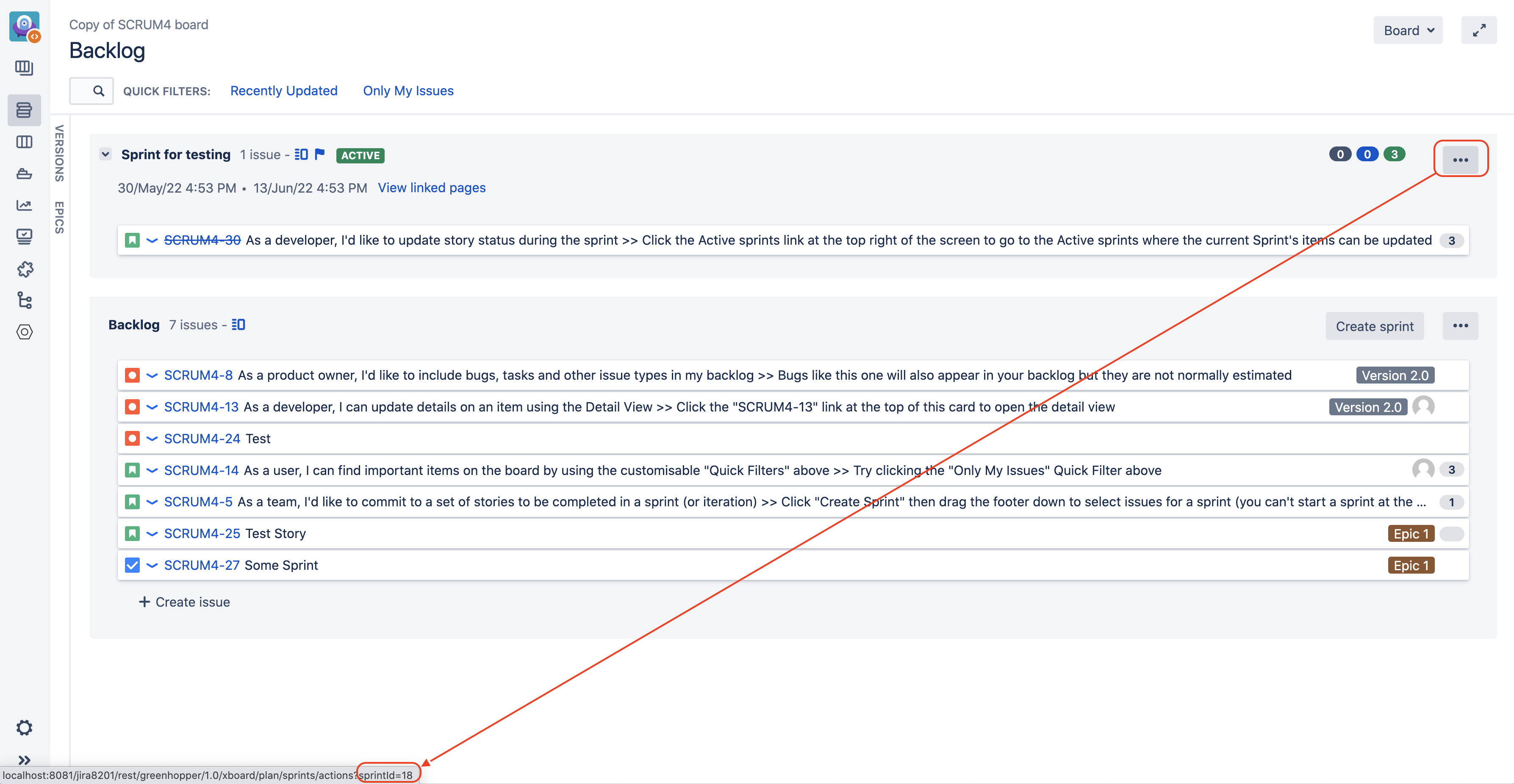

Identify the Sprint ID by hovering over the 3 dots next to the Sprint (from the Backlog page), and checking the URL at the bottom of the page, as shown in the screenshot below:

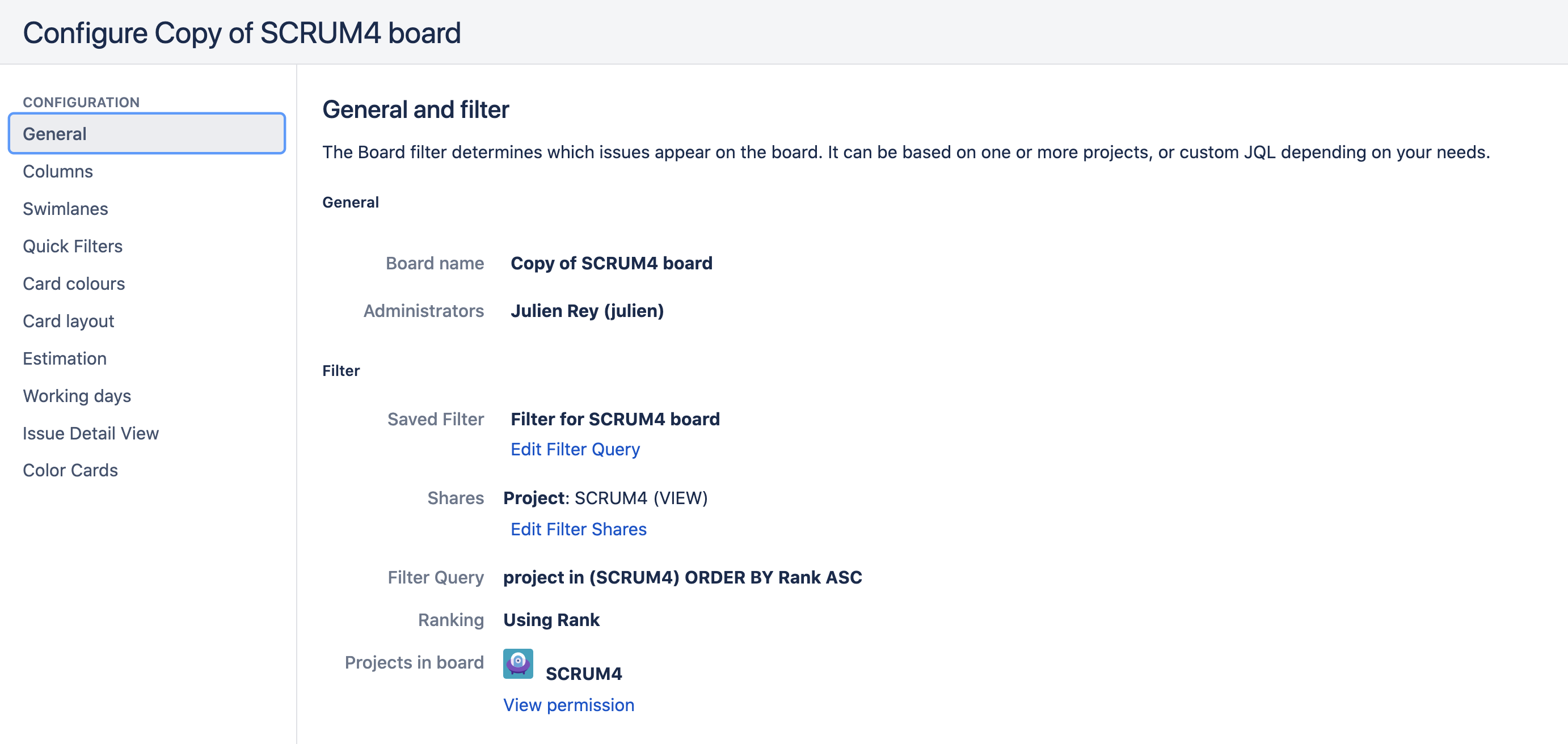

Go to the board general configuration page, by going to Board > Configuration > General and copy the query from the field Filter Query
