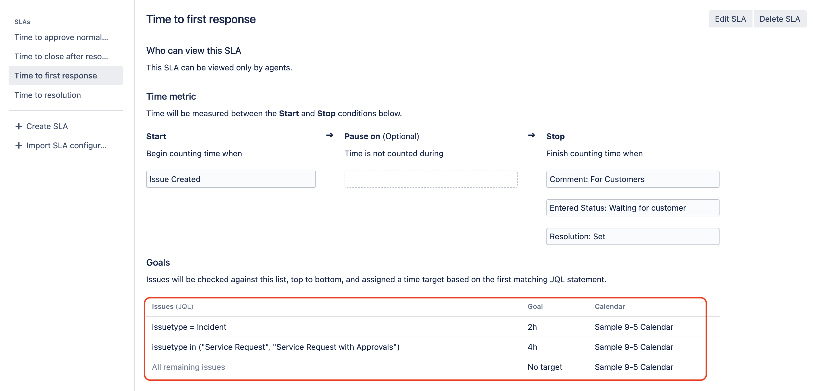

Root Cause 2 - The issue does not meet any of the SLA goal criteria
For an SLA to show in a JSM issue, the JSM issue needs to meet the JQL query of at least one of the goal configured for that SLA. If the issue does not meet any JQL query, and if the "All remaining issues" section of the SLA configuration does not have any target, the SLA will be missing from the issue.
Below is an example of scenario when an SLA will be missing from a JSM issue:

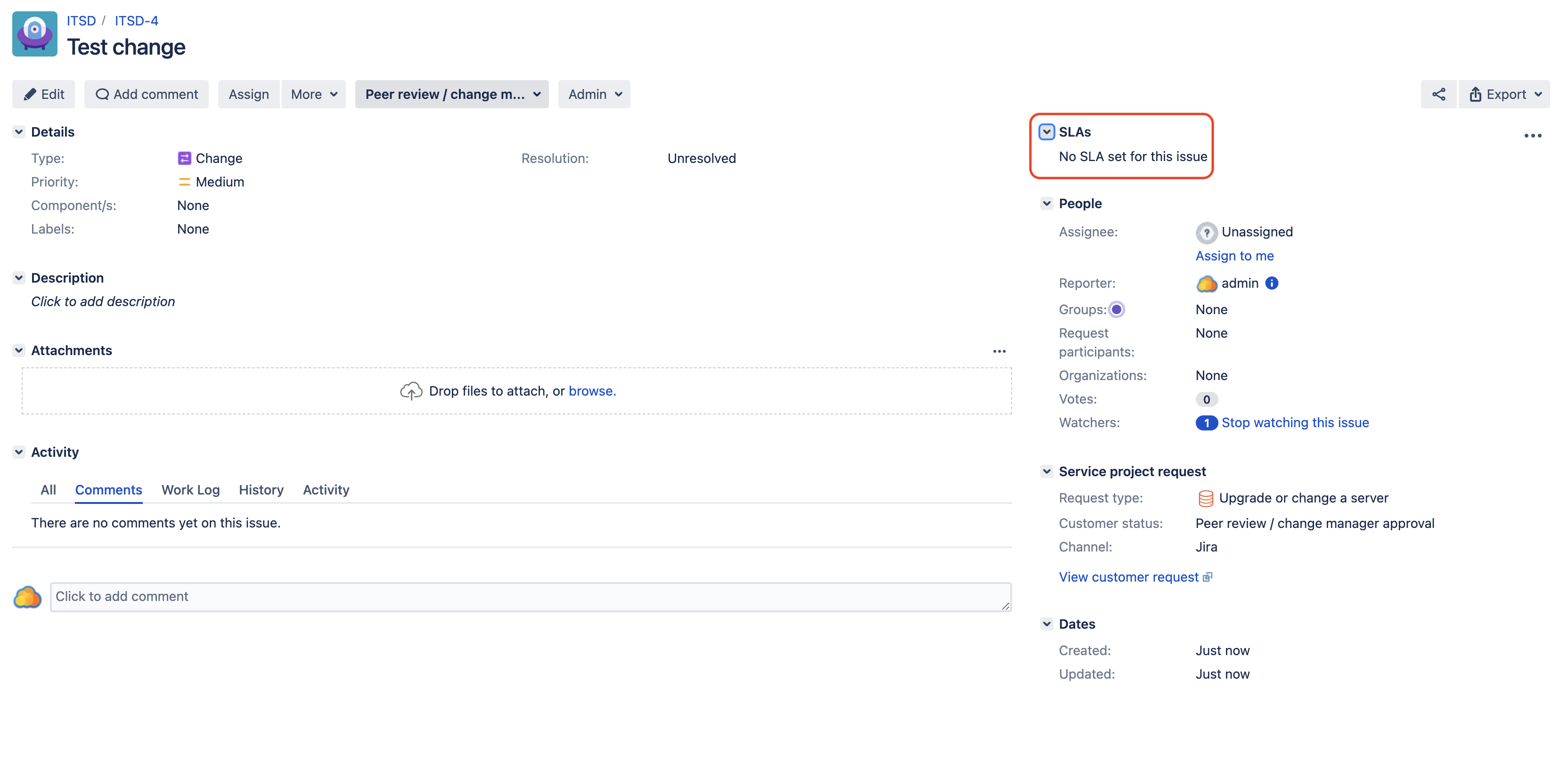

  • The SLA Time to first response is configured with a goal set only for issues of type Incident, "Service Request" and "Service Request with Approvals". The remaining issues don't have any target:
  • The JSM issue below is of type "Change". Since there is no target for this type of issue, the Time to first response SLA will not show in the SLA panel:

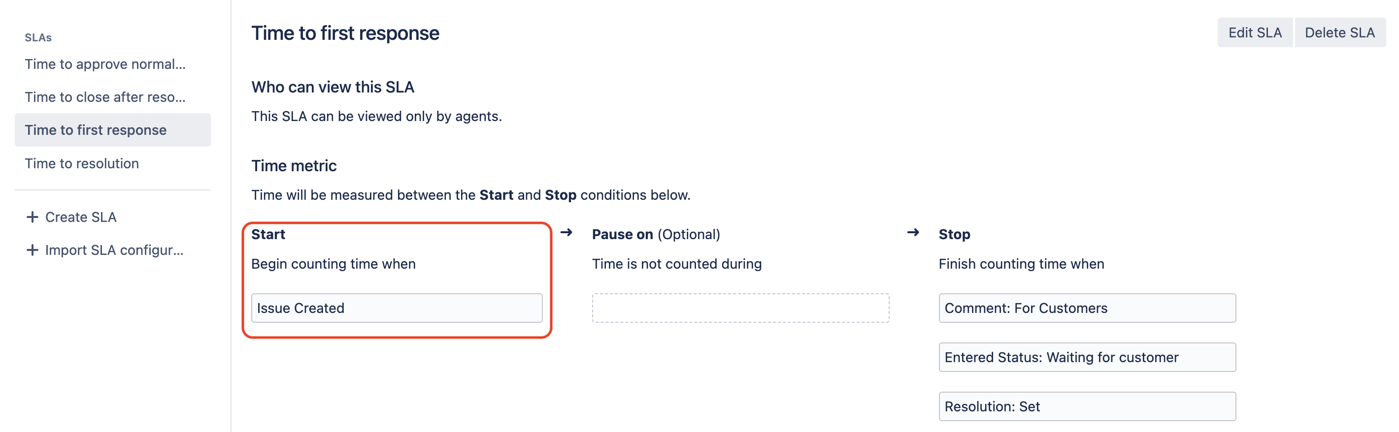

  • The Time to first response SLA is configured with Issue Created as the only Start condition:

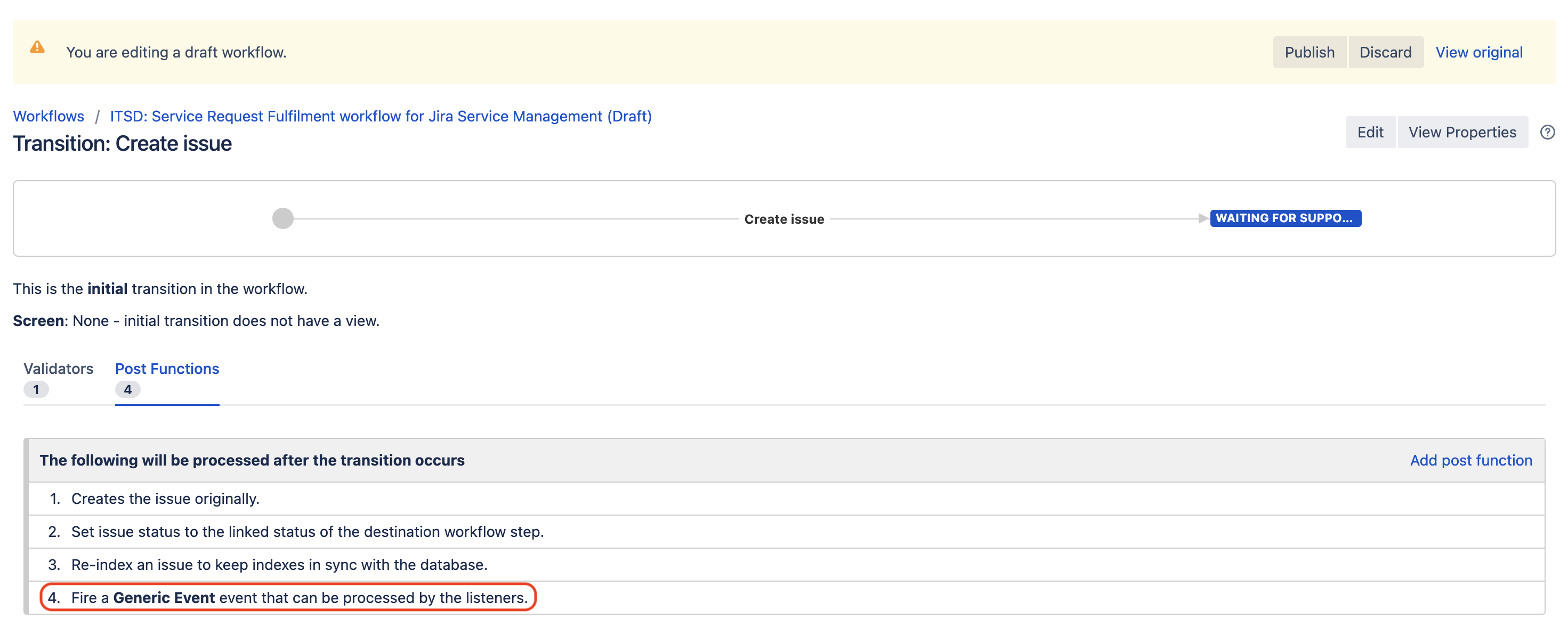

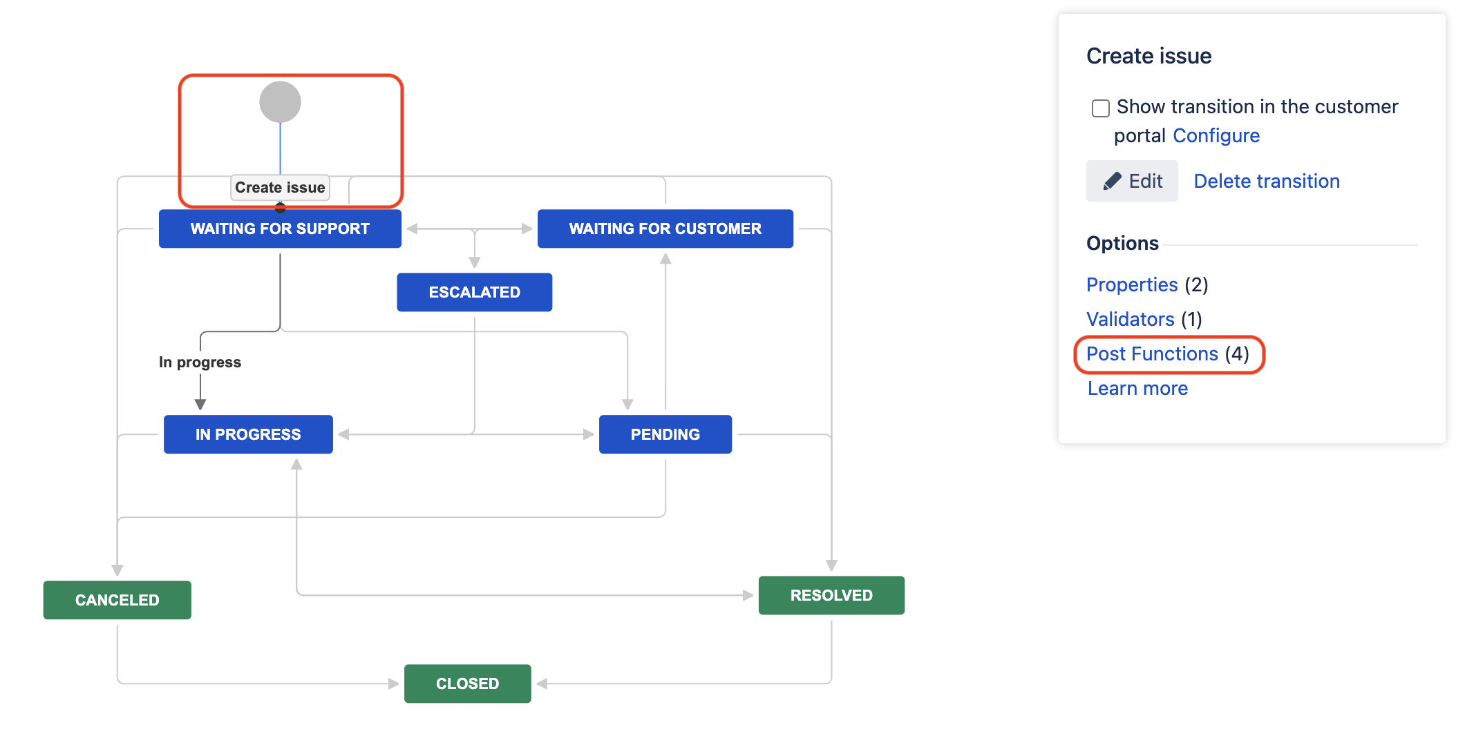

  • The workflow associated to the JSM issue where the SLA is missing is not firing the Issue Created event on the Create Issue transition. To check this:
    • Edit the workflow, go to the diagram mode, click on the Create Issue transition, and click on the Post Functions link:
    • Take a look at the list of post functions and note that a different event than the Issue Created event is fired:
