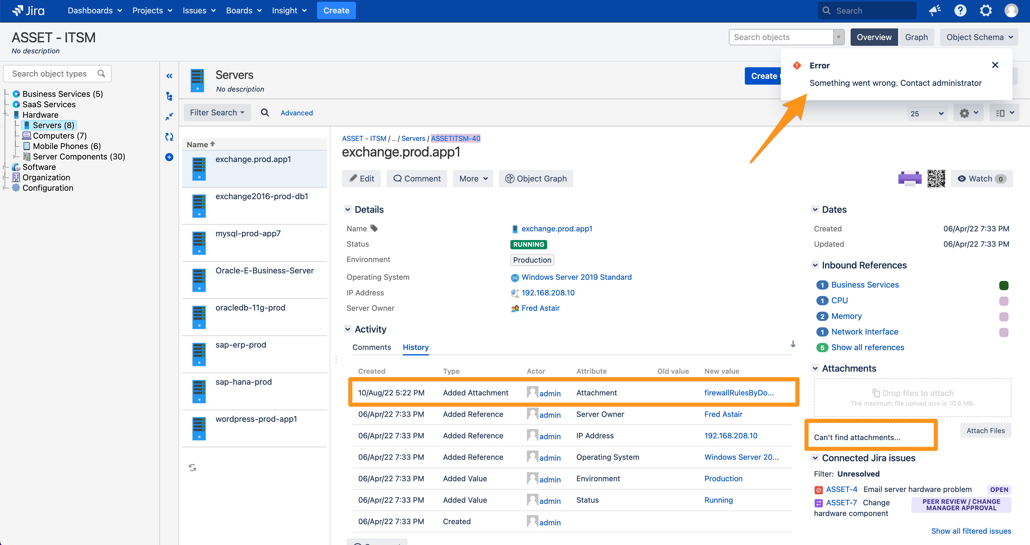

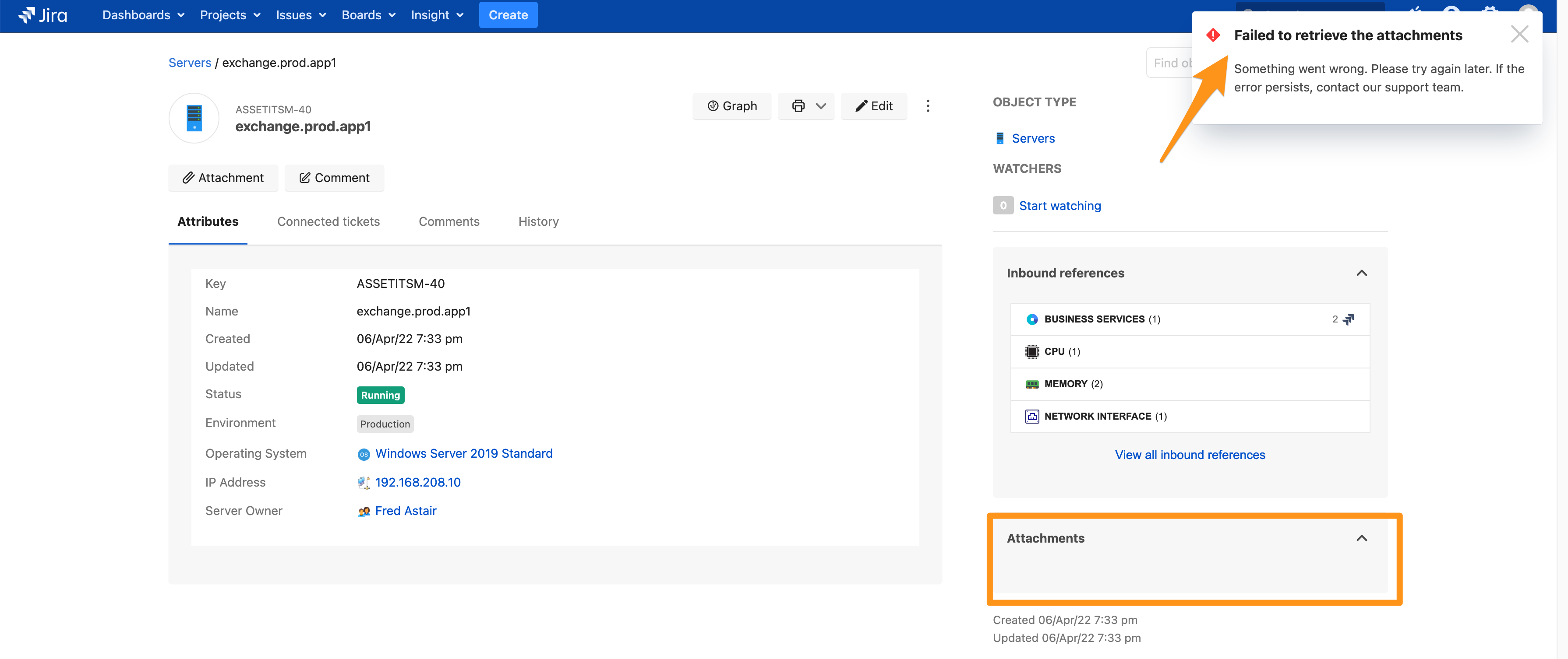

When browsing an object with existing attachment(s), the attachments do not appear in the attachments panel. There are error message and sign on the screen indicating there's issue with the object's attachments
Environment
Any Insight version
Diagnosis
  • From the UI, you could see errors like "Something went wrong. Contact administrator" or "Failed to retrieve the attachments". In the Attachments panel, it would be blank or with a message "Can't find attachments..."
