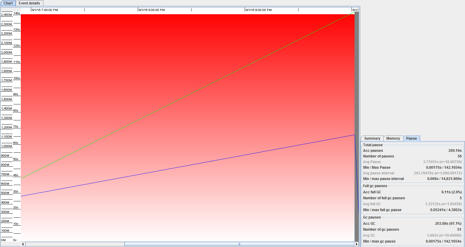

  • Troubleshoot Jira Server performance with GC logs takes a very long to finish.
    Sample GC Viewer:
