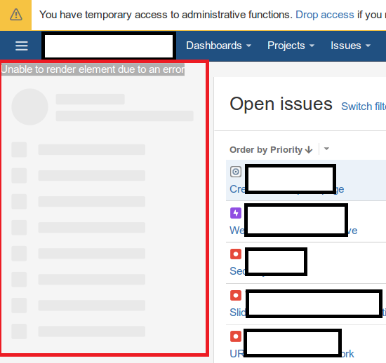

After upgrading to Jira Service Management 3.2.x, observe the problem below while browsing a Service Management project. The project navigation bar will not render properly with message Unable to render element due to an error on top of the bar:
