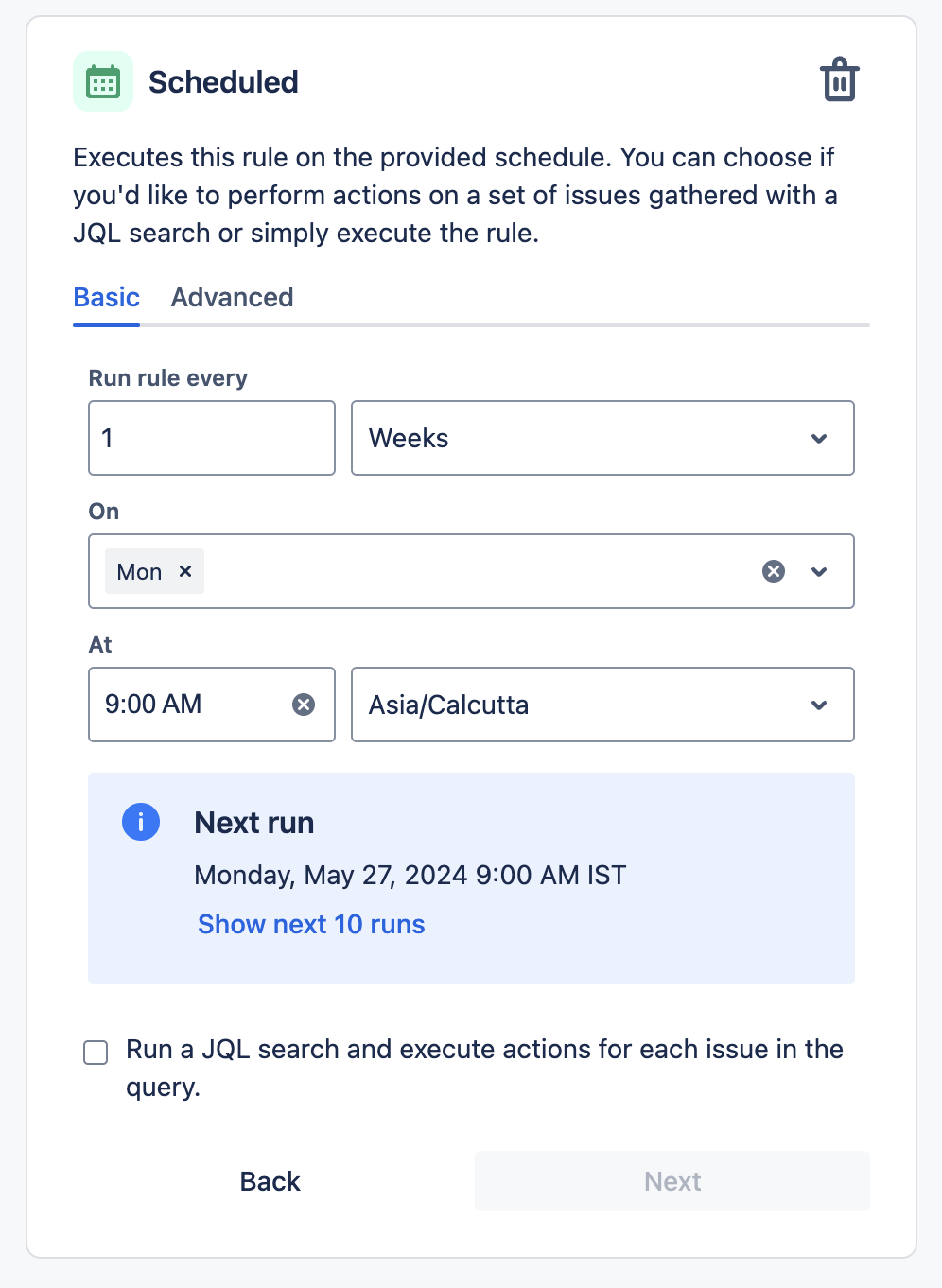

  1. Choose the trigger>Scheduled select the time interval you choose to get these emails for and also if there is a particular JQL you'd like to narrow it down to

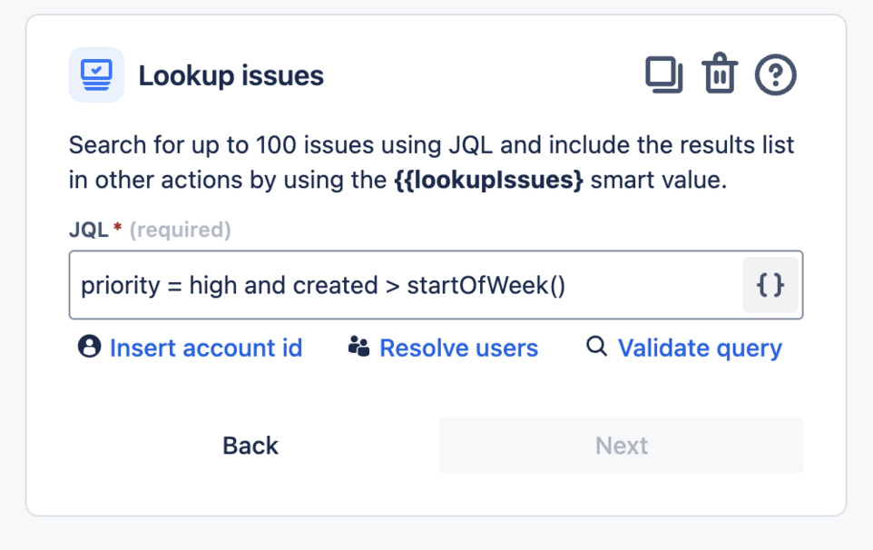

  2. Add an action > Lookup issues and use the JQL from the filter or one that gives you the expected results
    Lookup Issues smart value only returns the first 100 issues returned by the JQL. It would be good to narrow down the JQL as much as possible OR add multiple blocks for execution
