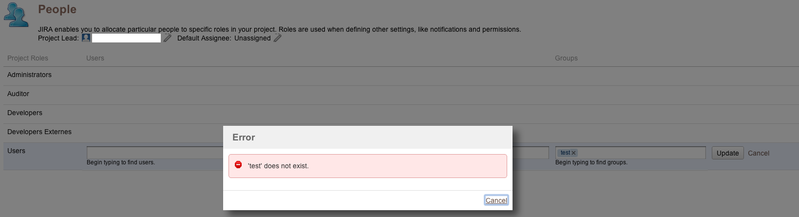

Jira is integrated with LDAP or Crowd. Upon adding a user to the group, Jira is able to auto-complete the group name in Jira, but upon clicking 'Update', the following error appears:
Error message with forbidden sign and message "test does not exist."
There is no correlating error in the atlassian-jira.log.
