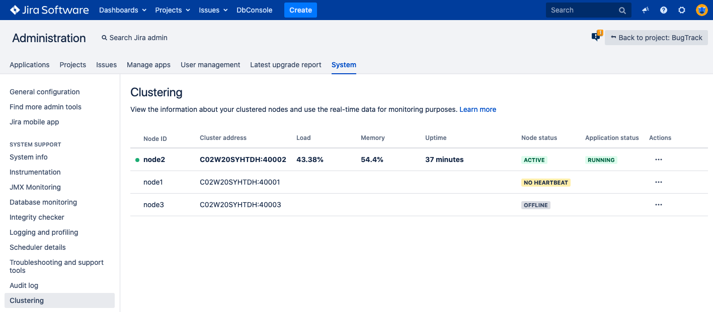

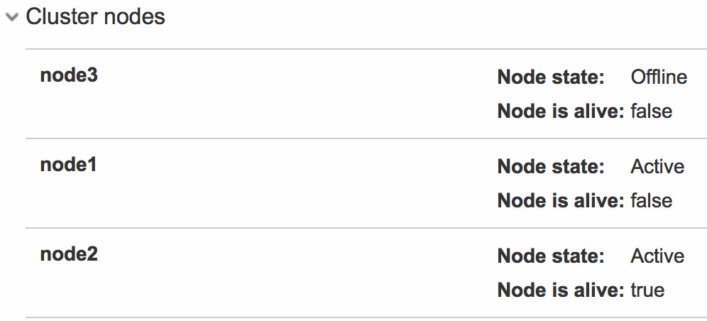

The nodes that show as active but not alive (that is with no heartbeat) or offline can clutter up your cluster information. In Jira 8.9 we improved the way cluster information is displayed however, you still needed to manually remove stale or offline nodes from the cluster.
That behavior changed in Jira 8.10 and later where stale nodes are automatically removed.
Pre-Jira 8.9
Jira 8.9 and later

Removing a stale node with no heartbeat
Nodes might show up active, but in fact, have no heartbeat if they have been killed abruptly. We advise stopping Jira gracefully to avoid that situation.
