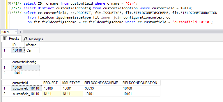

  1. Run this query to identify the ID of the custom field, using its name (case-sensitive):
    select ID, cfname from customfield where cfname = 'Car';
    Take note of the custom field ID in column ID.
  2. Run this query to identify which custom field configuration is being used by the custom field (replace 10110 with the custom field ID from step 1):
    select distinct customfieldconfig from customfieldoption where customfield = 10110;   // if you want to view more details, run this query instead: // select * from customfieldoption where customfield = 10110;
    Take note of the field config ID(s) in column customfieldconfig (each ID is a different context of the custom field that can be seen from the GUI, and they have one or more options).
  3. Run this query to identify which custom field config scheme uses which custom field configuration (replace 10110 with the custom field ID from step 1):
    select cc.customfield, cc.PROJECT, fit.ISSUETYPE, fit.FIELDCONFIGSCHEME, fit.FIELDCONFIGURATION from fieldconfigschemeissuetype fit inner join configurationcontext cc on fit.fieldconfigscheme = cc.fieldconfigscheme where cc.customfield = 'customfield_10110';
    Sample outputs and explanations:
    According to the above outputs:
    - customfieldconfig10401 (query#2) refers to fieldconfiguration10401 (query#3), which uses fieldconfigscheme10401 (query#3). JIRA looks for 10401 and finds it (query#2), so this is fine ✔️
    customfieldconfig 10400 (query#2) refers to fieldconfiguration 10400 (query#3), which uses fieldconfigscheme 99999 (query#3). JIRA looks for 99999 but finds 10400 (query#2), so this is the problem that affects Project Import
  4. What we're supposed to do is to replace 10400 with 99999 using the following query (replace 10110 with the custom field ID from step 1):
    update customfieldoption set customfieldconfig = 99999 where customfield = 10110 and customfieldconfig = 10400;
    If the custom field has a default value, there should be an update on genericconfiguration table:
    update genericconfiguration set datakey=9999 where datakey in (select distinct customfieldconfig from customfieldoption where customfield =(select ID from customfield where cfname = 'Car'));
    - If there're more association discrepancies, run the Update query for each of them, following the above pattern.
    - You don't need to Update wherefieldconfiguration=fieldconfigschemefor query#3.
    - There may be more entries in query#3 than query#2. This is normal if the field has one or more contexts that do not have any options. Just ignore those entries.
    The Update in query#4 will causeproblemto the staging server (of the source instance) itself, as JIRA will look (in the other direction) for 99999 infieldconfiguration(for other operations/purposes), which may refer to a different or non-existent configuration. This is how the data are messed,howeverit doesn't affect Project Import (which doesn't look in that direction).
  5. Generate a new XML backup from the staging server.
  6. Use the backup to restore the project into the target instance (once done destroy it).
