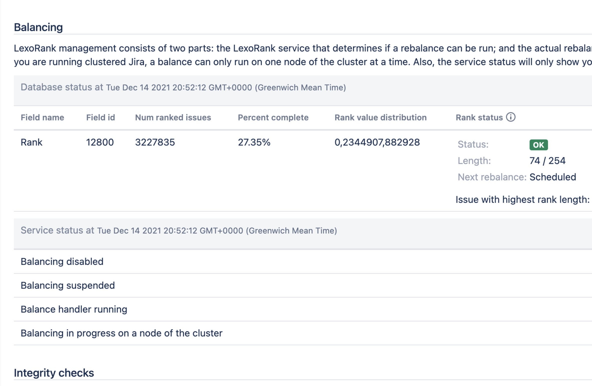

  • The LexoRank balancer job runs very slow. The percentage completion can be tracked under Administration () > System > Lexorank management page. It may only progress by 1% in 4-5 hours depending upon the number of issues in the instance.

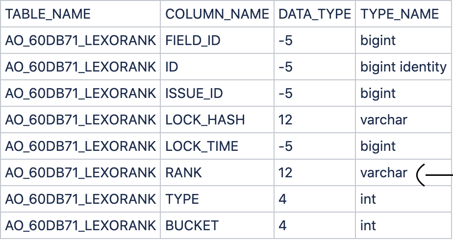

Run the below query in the Database and verify if Datatype of RANK and LOCK_HASH is varchar as can be seen below:
exec sp_columns 'AO_60DB71_LEXORANK' ;

An incorrect data type for LOCK_HASH and RANK column can cause SQL Server to use an inefficient execution plan which is likely to take more than 1500ms to complete, which in turn can trigger the hardcoded timeout in JIRA and the ranking operation will fail.
