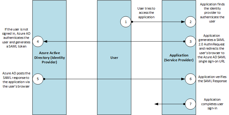

Finally, let’s have a look at the SSO authentication process between Jira and Azure SSO by using the SP-Initiated SSO: Redirect/POST Bindings
  1. A user tries to access Jira by using a particular URL. They have no active login session (e.g., security context). The Service Provider will save the URL requested by the user.
  2. The application finds the Identity Provider to authenticate the user.
  3. The Service Provider returns a request to the user's browser with the 302 or 303 redirect code. The HTTP Location header will include the SSO service URL, and the URL-variable SAMLRequest will pass the <AuthnRequest> request body. Here's an example:
    <samlp:AuthnRequest xmlns="urn:oasis:names:tc:SAML:2.0:metadata" ID="id6c1c178c166d486687be4aaf5e482730" Version="2.0" IssueInstant="2013-03-18T03:28:54.1839884Z" xmlns:samlp="urn:oasis:names:tc:SAML:2.0:protocol"> <Issuer xmlns="urn:oasis:names:tc:SAML:2.0:assertion">https://www.example.com</Issuer> </samlp:AuthnRequest>
    The browser will then handle the received redirect and issue HTTP GET to the Identity Provider URL, passing the SAMLRequest.
  4. The SSO service checks if the user has an active login session which needs to comply with the authentication type requested as it passed in the AuthnRequest from the Service Provider (Jira). If this session isn't found, the user has to authenticate on the Identity Provider with their login and password. As a result, the user is authenticated on the Identity Provider, where a security context is created for them.
  5. The Identity Provider's SSO service generates a SAML <Response> which includes an assert with this user's security context. The SAMLResponse body is transferred in the base64 encoding in the <samlp:Response> element. A response to a successful sign-on attempt looks similar to the following example:
    <samlp:Response ID="_a4958bfd-e107-4e67-b06d-0d85ade2e76a" Version="2.0" IssueInstant="2013-03-18T07:38:15.144Z" Destination="https://example.com/identity/inboundsso.aspx" InResponseTo="id758d0ef385634593a77bdf7e632984b6" xmlns:samlp="urn:oasis:names:tc:SAML:2.0:protocol"> <Issuer xmlns="urn:oasis:names:tc:SAML:2.0:assertion"> https://login.microsoftonline.com/82869000-6ad1-48f0-8171-272ed18796e9/</Issuer> <ds:Signature xmlns:ds="https://www.w3.org/2000/09/xmldsig#"> ... </ds:Signature> <samlp:Status> <samlp:StatusCode Value="urn:oasis:names:tc:SAML:2.0:status:Success" /> </samlp:Status> <Assertion ID="_bf9c623d-cc20-407a-9a59-c2d0aee84d12" IssueInstant="2013-03-18T07:38:15.144Z" Version="2.0" xmlns="urn:oasis:names:tc:SAML:2.0:assertion"> <Issuer>https://login.microsoftonline.com/82869000-6ad1-48f0-8171-272ed18796e9/</Issuer> <ds:Signature xmlns:ds="https://www.w3.org/2000/09/xmldsig#"> ... </ds:Signature> <Subject> <NameID>Uz2Pqz1X7pxe4XLWxV9KJQ+n59d573SepSAkuYKSde8=</NameID> <SubjectConfirmation Method="urn:oasis:names:tc:SAML:2.0:cm:bearer"> <SubjectConfirmationData InResponseTo="id758d0ef385634593a77bdf7e632984b6" NotOnOrAfter="2013-03-18T07:43:15.144Z" Recipient="https://example.com/identity/inboundsso.aspx" /> </SubjectConfirmation> </Subject> <Conditions NotBefore="2013-03-18T07:38:15.128Z" NotOnOrAfter="2013-03-18T08:48:15.128Z"> <AudienceRestriction> <Audience>https://www.example.com</Audience> </AudienceRestriction> </Conditions> <AttributeStatement> <Attribute Name="http://schemas.xmlsoap.org/ws/2005/05/identity/claims/name"> <AttributeValue>testuser@example.com</AttributeValue> </Attribute> <Attribute Name="http://schemas.microsoft.com/identity/claims/objectidentifier"> <AttributeValue>3F2504E0-4F89-11D3-9A0C-0305E82C3301</AttributeValue> </Attribute> ... </AttributeStatement> <AuthnStatement AuthnInstant="2013-03-18T07:33:56.000Z" SessionIndex="_bf9c623d-cc20-407a-9a59-c2d0aee84d12"> <AuthnContext> <AuthnContextClassRef> urn:oasis:names:tc:SAML:2.0:ac:classes:Password</AuthnContextClassRef> </AuthnContext> </AuthnStatement> </Assertion> </samlp:Response>
  6. The browser will issue a POST request to the Service Provider (Jira) passing the SAMLResponse. The Service Provider will check the <Response> content and create a new local security for this user.
