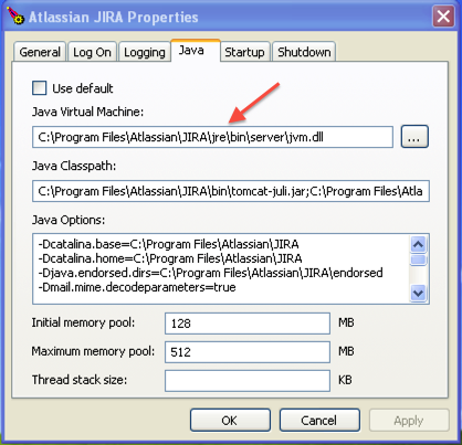

  2. Point your Windows Service to a JAVA 64-bit installation;
    1. Open the Windows Services via Command Line as in the instructions of this documentation (expand Windows Service section);
    2. Into the JAVA properties screen, click on the Java tab to see the list of current start-up options;
    3. Edit the Java Virtual Machine to point to the jvm.dll file of a JAVA 64-bit installation:
