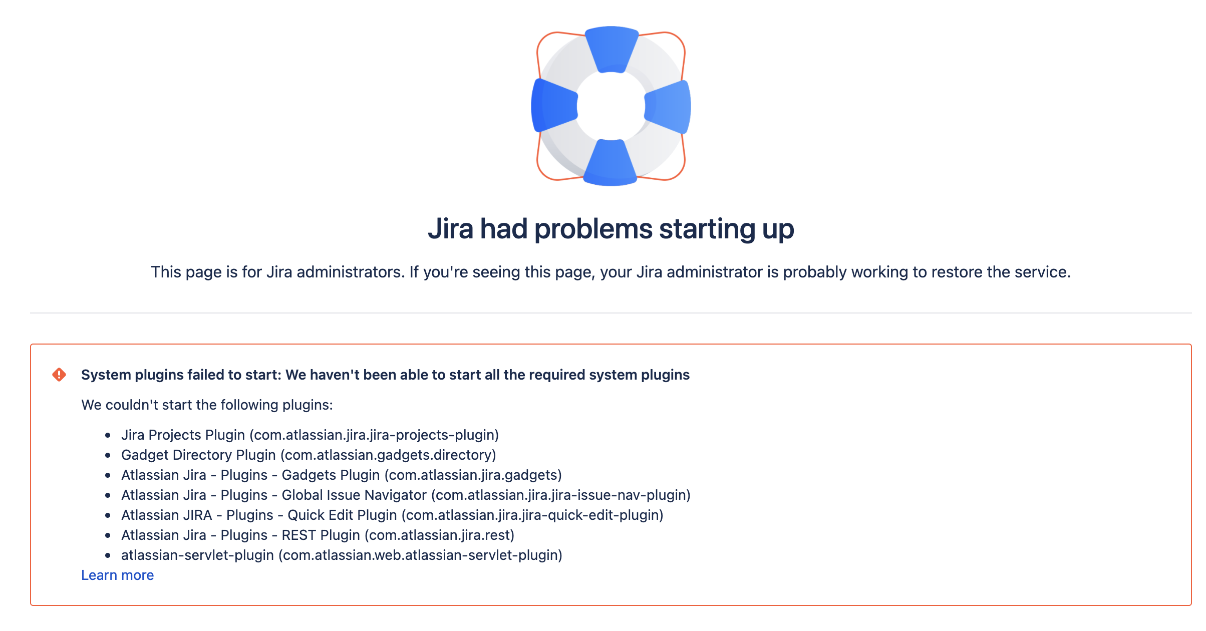

Jira starts up but shows a Jira had problems starting up page when accessed through the Browser:
The page may report system plugins or 3rd party user installed plugins. Some root causes are the same.
