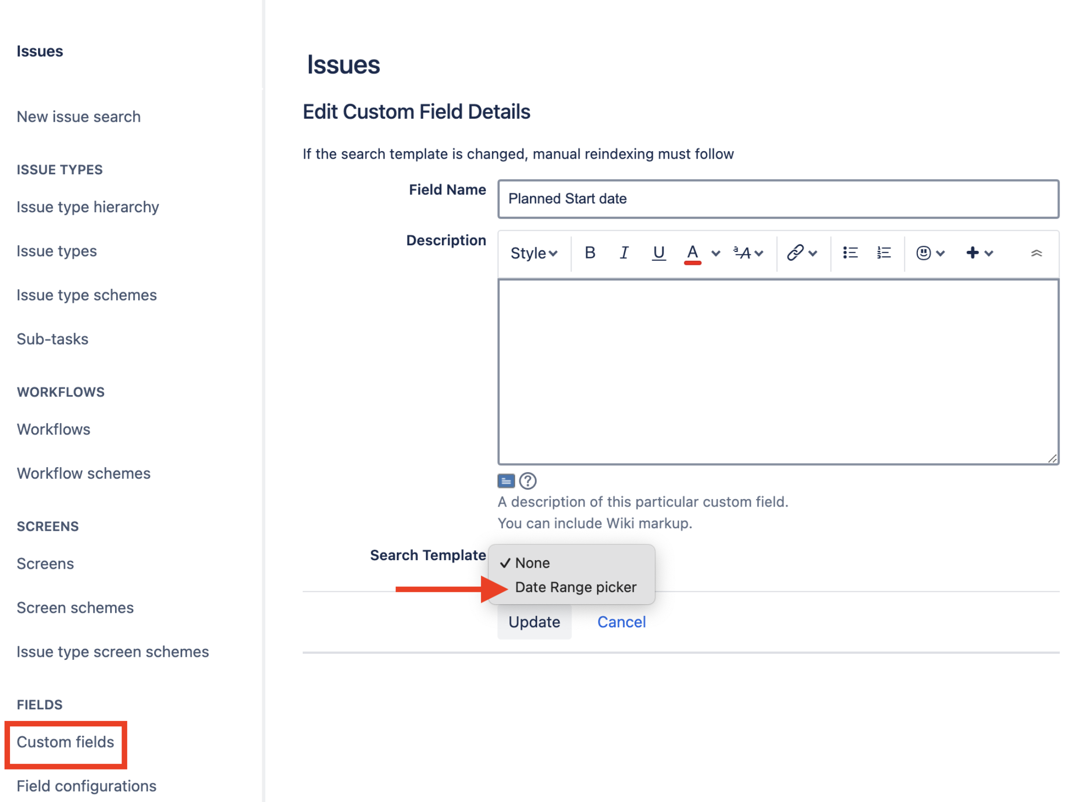

It was found that the Search Template is marked as `None` for the Planned Start date custom field which has caused the issue
Solution
Select the 'Date range picker' from the drop-down menu under the Search Template field to fix the issue.
Edit the field's details and select 'Date range picker' under the Search Template option.
