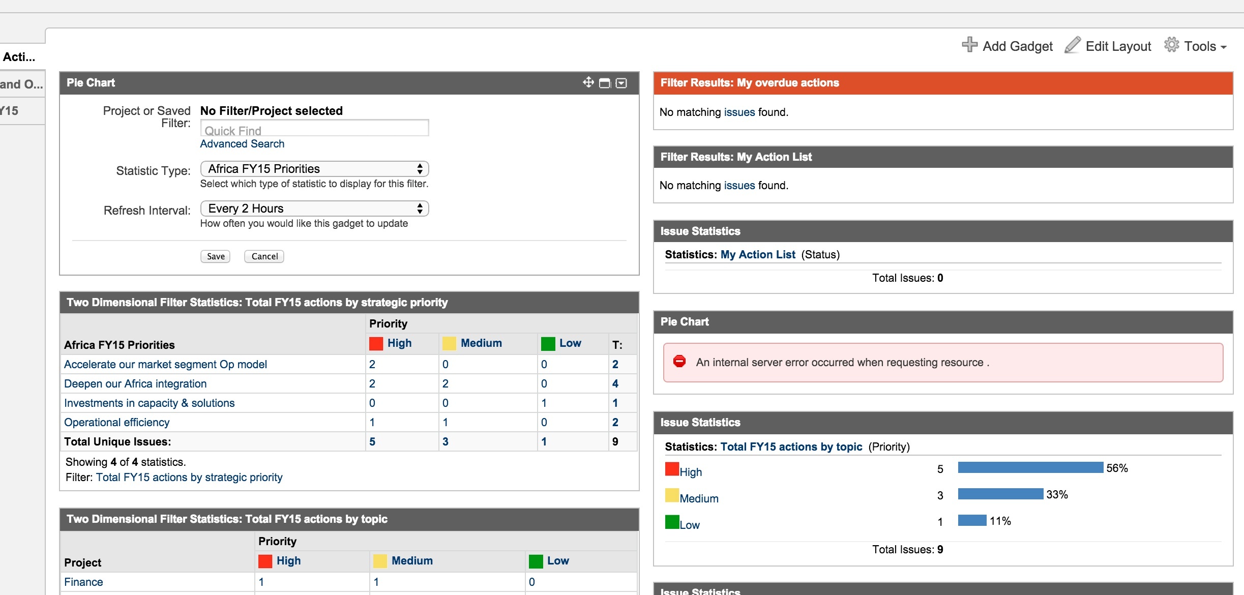

All the pie charts on the Dashboards are not rendering. It displays an error message message "An internal server error occurred when requesting resource"
A reboot of the server solves this for a few minutes, but then it goes back to the error.
The following appears in the atlassian-jira.log:
  2015-01-12 03:51:15,616 http-bio-8080-exec-17 ERROR meleni.moodley 231x4340x1 18zezuv 145.62.32.129 /rest/gadget/1.0/piechart/generate [common.error.jersey.ThrowableExceptionMapper] Uncaught exception thrown by REST service java.lang.RuntimeException: Error generating pie chart at com.atlassian.jira.charts.PieChart.generateChart(PieChart.java:205) at com.atlassian.jira.charts.DefaultChartFactory.generatePieChart(DefaultChartFactory.java:91) at sun.reflect.GeneratedMethodAccessor507.invoke(Unknown Source) at sun.reflect.DelegatingMethodAccessorImpl.invoke(Unknown Source) at java.lang.reflect.Method.invoke(Unknown Source) at com.atlassian.multitenant.impl.MultiTenantComponentFactoryImpl$AbstractMultiTenantAwareInvocationHandler.invokeInternal(MultiTenantComponentFactoryImpl.java:181) at com.atlassian.multitenant.impl.MultiTenantComponentFactoryImpl$MultiTenantAwareInvocationHandler.invoke(MultiTenantComponentFactoryImpl.java:211) at com.sun.proxy.$Proxy412.generatePieChart(Unknown Source) <+2> at java.lang.reflect.Method.invoke(Unknown Source) at com.atlassian.plugin.osgi.hostcomponents.impl.DefaultComponentRegistrar$ContextClassLoaderSettingInvocationHandler.invoke(DefaultComponentRegistrar.java:129) at com.sun.proxy.$Proxy412.generatePieChart(Unknown Source) <+2> at java.lang.reflect.Method.invoke(Unknown Source) at com.atlassian.plugin.osgi.bridge.external.HostComponentFactoryBean$DynamicServiceInvocationHandler.invoke(HostComponentFactoryBean.java:154) at com.sun.proxy.$Proxy412.generatePieChart(Unknown Source) at com.atlassian.jira.gadgets.system.PieChartResource.createChart(PieChartResource.java:145) at com.atlassian.jira.gadgets.syste2015-01-12 04:04:32,712 StreamsCompletionService::thread-2674 WARN anonymous com.atlassian.streams.internal.ActivityProviderConnectionMonitorImpl:activityProviderMonitor [atlassian.streams.internal.ActivityProviderConnectionMonitorImpl$ActivityMonitorJob] Could not reach provider mt2; it will be omitted from the stream. The connection will be retried in 5 minutes
