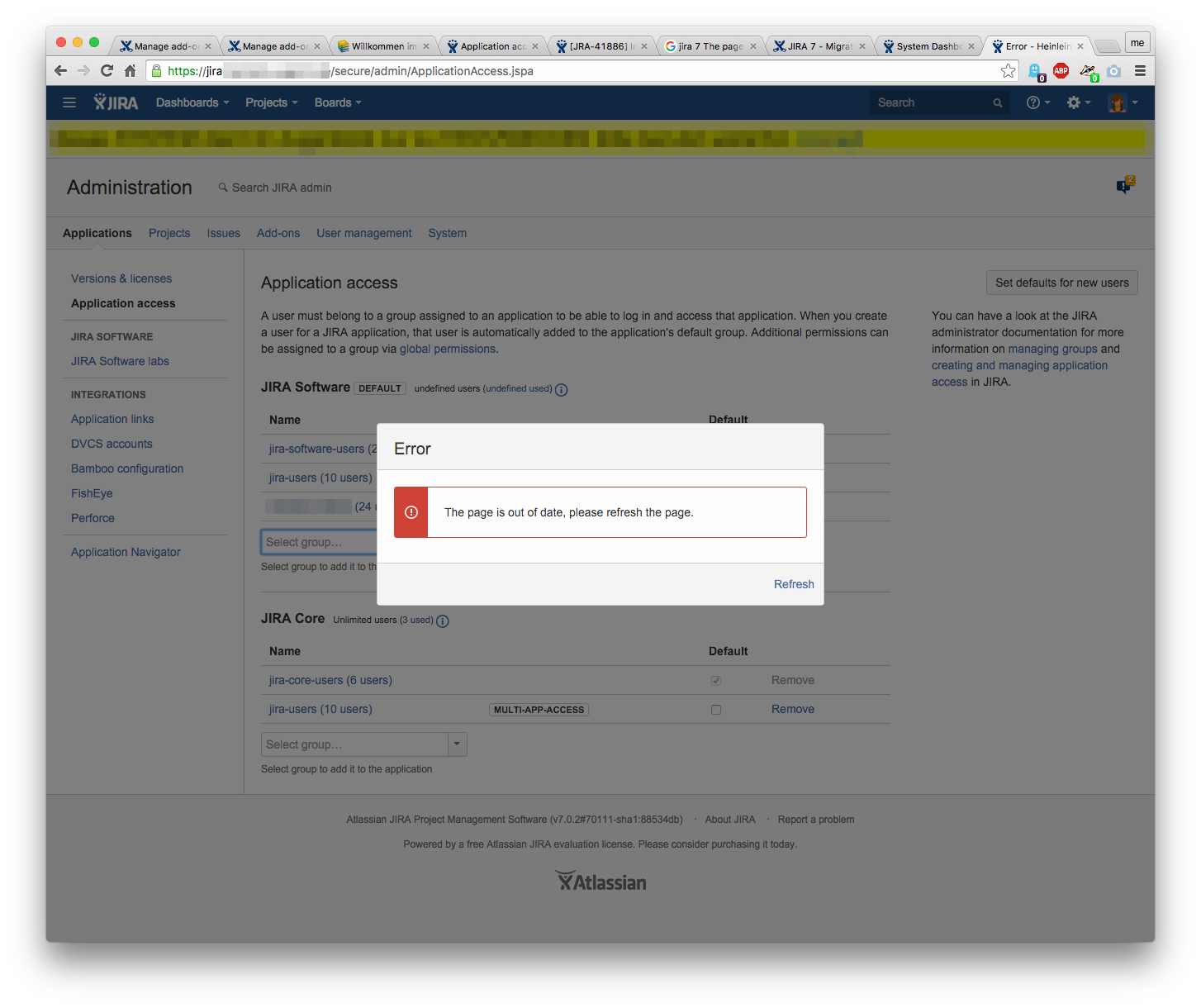

The following error message pops up when you try to add any group to a JIRA Application from the Application Access page:
The page is out of date, please refresh the page.

When trying to grant a group Application Access, a PUT request is sent to Jira's REST API which utilizes ETag HTTP headers to ensure the request is updating the latest version available. If these headers are missing the REST API returns an HTTP error code, 412 Precondition Failed. This can be observed by capturing a HAR file as shown below and inspecting the If-Match header which is null:
