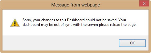

2. The following window will prompt when trying to edit or made changes to the dashboard
