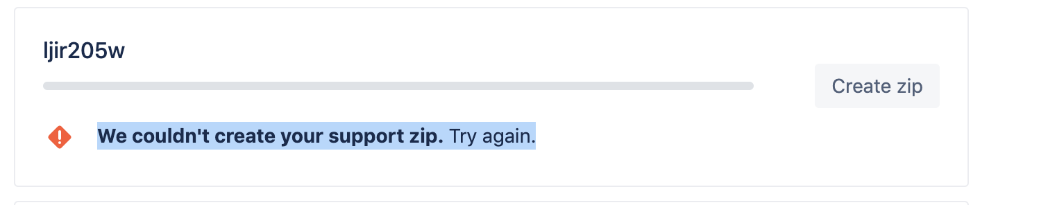

After migrating to or copying an Oracle based database, actions in Jira fail with interface errors such as:
Jira logs will throw an ORA-02296 error related to null values found:
