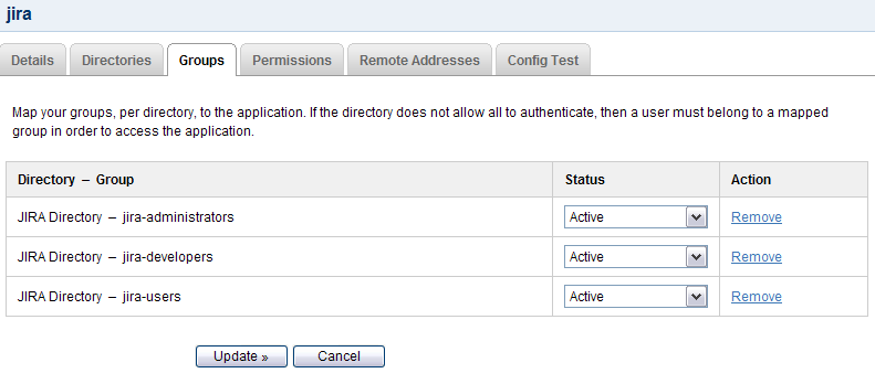

  1. Login to Crowd and check the Specify which users can log in to JIRA configuration and check whether both {{jira-users}} and {{jira-software-users}} is added to the permitted group.
  2. If the jira-software-users or jira-users group is missing or inactive, add both of the groups in this screen :
  3. Re-sync your Crowd Directory from JIRA and try to login with your regular username again.
