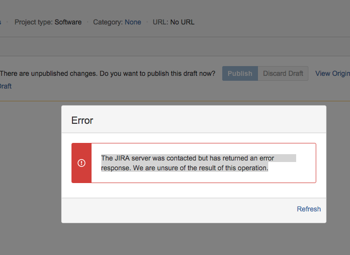

When navigating to the workflows in a particular JIRA project, you receive the following error message:
The JIRA server was contacted but has returned an error response. We are unsure of the result of this operation.
