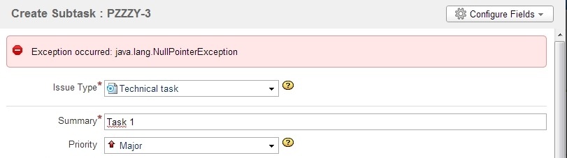

User is not able to create sub-task and the following error thrown in the web UI:
