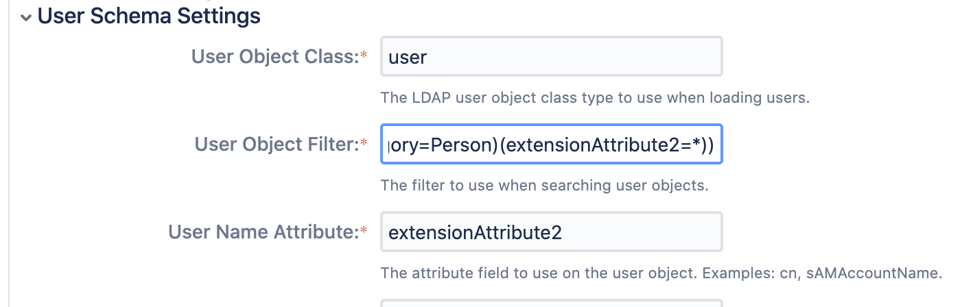

Modify your JIRA User Directory Configuration in (
) (Administration) > User Management > User Directories so that the "User Name Attribute" and "User Object Filter" (in User Schema Settings) is changed to the temporary attribute.
Synchronize the directory. At this point you should see your user's usernames updated to the new format.
Verify all users are able to login and have not lost any data.
Users will need to log in by using whatever has been set in their "extension attributes".
