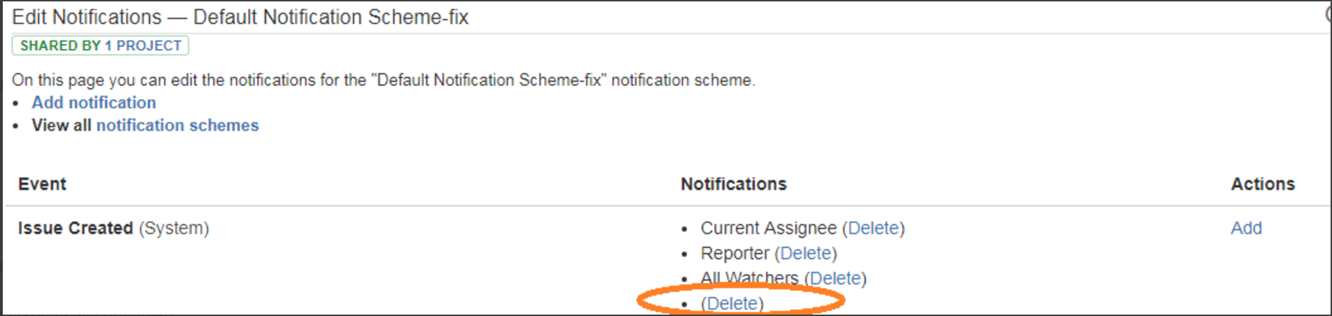

Remove any empty Recipient values from the Notification Scheme
Check if there is an empty string Recipient against a Notification Event on the Notification Schemes page.
screenshot of notification event page. Under Notifications, one recipient appears to be empty or null. Only the delete link is visible.
