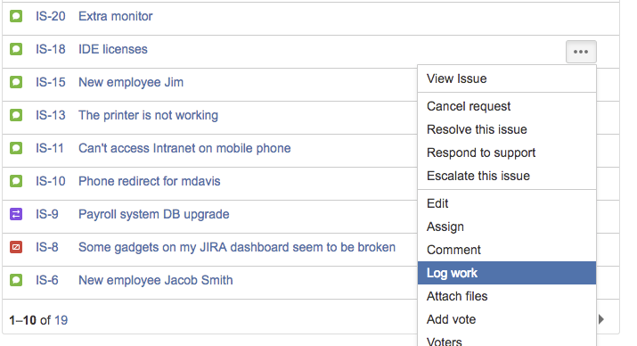

When trying to Log Work from the "Filter Result" gadget using the Triple Dot > Log Work it will return a 400 HTTP Error instead.

  • Look at the URL when the HTTP 400 Error appears and see if the URL is NOT like the following:
1 http://local:8119/jira7_11_2/secure/CreateWorklog!default.jspa?id=10001&returnUrl=http%3A%2F%2Fnasilemak.local%3A8119%2Fjira7_11_2%2Fsecure%2FDashboard.jspa%3FselectedIssueId%3D10001&atl_token=BE6Y-LKBE-OOOI-C168_fe30837e53222066a0ac4e1bffa6fd70877a96d5_lin
ℹ️ This is the expected URL shown when doing the operation.
  • Try disabling Tempo and check if the option is missing or the feature could work properly.
Cause
The issue appears to be caused by the Tempo Plugin and the URL shown when doing the operation would not be like the above but will look like the following:
1 https://jira.domain.here/secure/&returnUrl=https%3A%2F%2Fjira.domain.here%2Fsecure%2FDashboard.jspa%3FselectPageId%3D10001%26selectedIssueId%3D10001&atl_token=<Token String Here>
