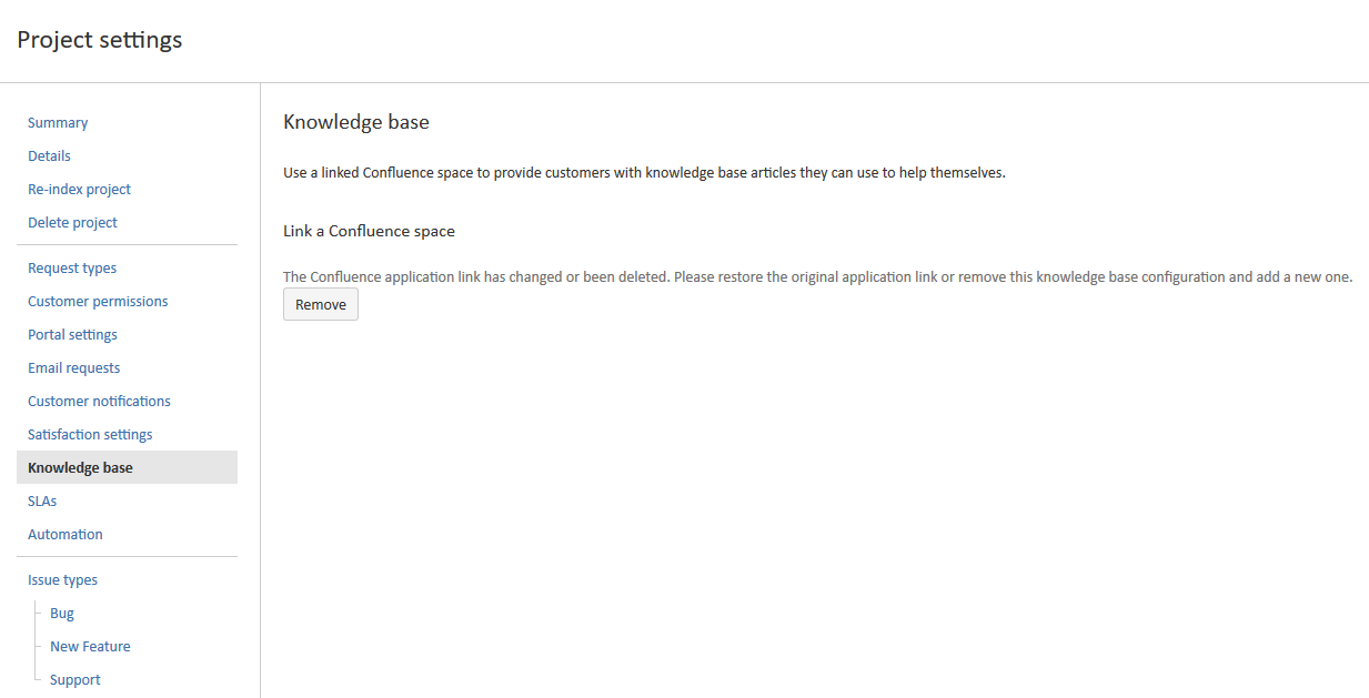

Imagine the use case below:
  1. Search for KBs and a few article links appear in the search result.
  2. You click on the first one to view the article, however, it says page not found.
  3. When you check on the URL of the article, it's pointing to the production Confluence instead of staging Confluence.
  4. You then check the server ID of both the Confluence instances and realize that the server ID is the same.
  5. You change the server ID of the staging Confluence based on this article: How to change the server ID of Confluence.
  6. You recreate the AppLinks with the exact same configuration.
  7. You notice that the integration between the Service Management project and the Confluence space for KB is broken and there's no other way to fix it other than removing the integration and re-configure it.
