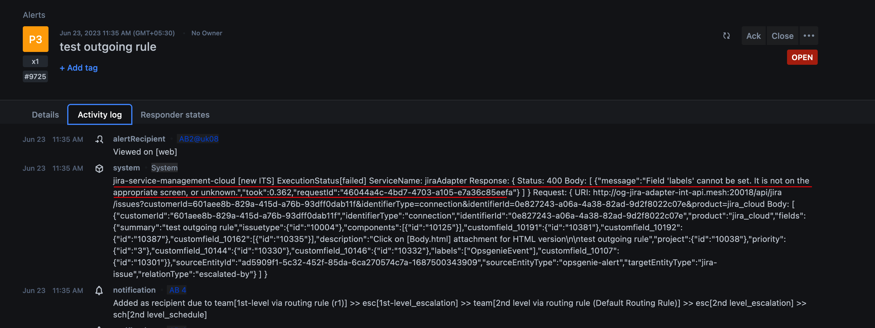

  4. Labels field: The labels field must be added on the 'create issue screen', this is required because Opsgenie adds the label 'OpsgenieEvent' automatically on all the tickets created by the the JSM integration.
    • Example: The highlighted message below suggests that the labels field is not added to the 'create issue screen' screen for the issue type selected in the outgoing automation rule
To identify the exact issue, Inspect the activity logs by clicking on the Activity log tab on the alert and search for any failed execution statuses related to the Jira Service Management integration. If you still encounter issues, consider reaching out to Atlassian Support for further assistance.
