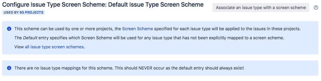

In the default Issue Type scheme, you will see the following error:
The following appears in the logs
/secure/admin/ConfigureIssueTypeScreenScheme.jspa [webwork.util.ValueStack] query="/issueTypeScreenSchemeEntities/empty" {[id="null" type="5" values=""]} {[id="issueTypeScreenSchemeEntities" type="8" values=""]} {[id="empty" type="8" values=""]} java.lang.reflect.InvocationTargetException
Caused by: java.lang.NullPointerException at com.atlassian.jira.issue.comparator.IssueTypeKeyComparator.compare(IssueTypeKeyComparator.java:36) at com.atlassian.jira.issue.fields.screen.issuetype.IssueTypeScreenSchemeEntityImpl.compareTo(IssueTypeScreenSchemeEntityImpl.java:156)
