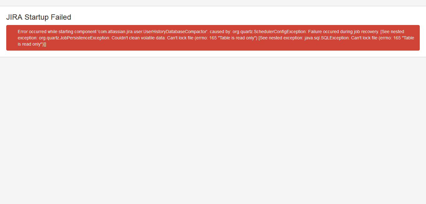

After starting JIRA the following error is displayed when attempting to access the application:
The following appears in the atlassian-jira.log
