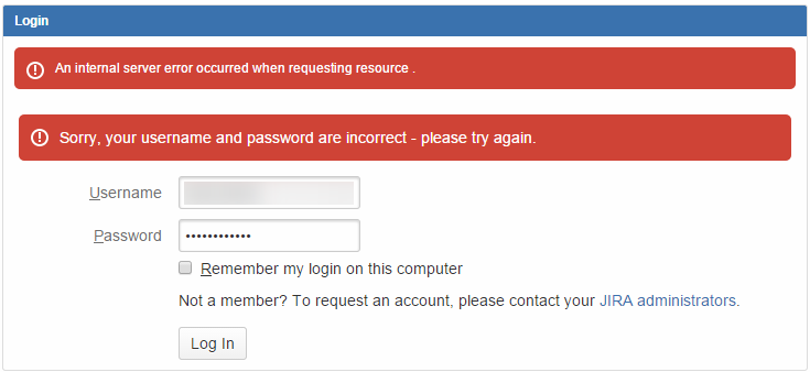

When a user tries to log in, they can face the following error message:
An internal server error occurred when requesting resource
A screenshot of log in attempt
ℹ️ A 500 error screen may appear instead
