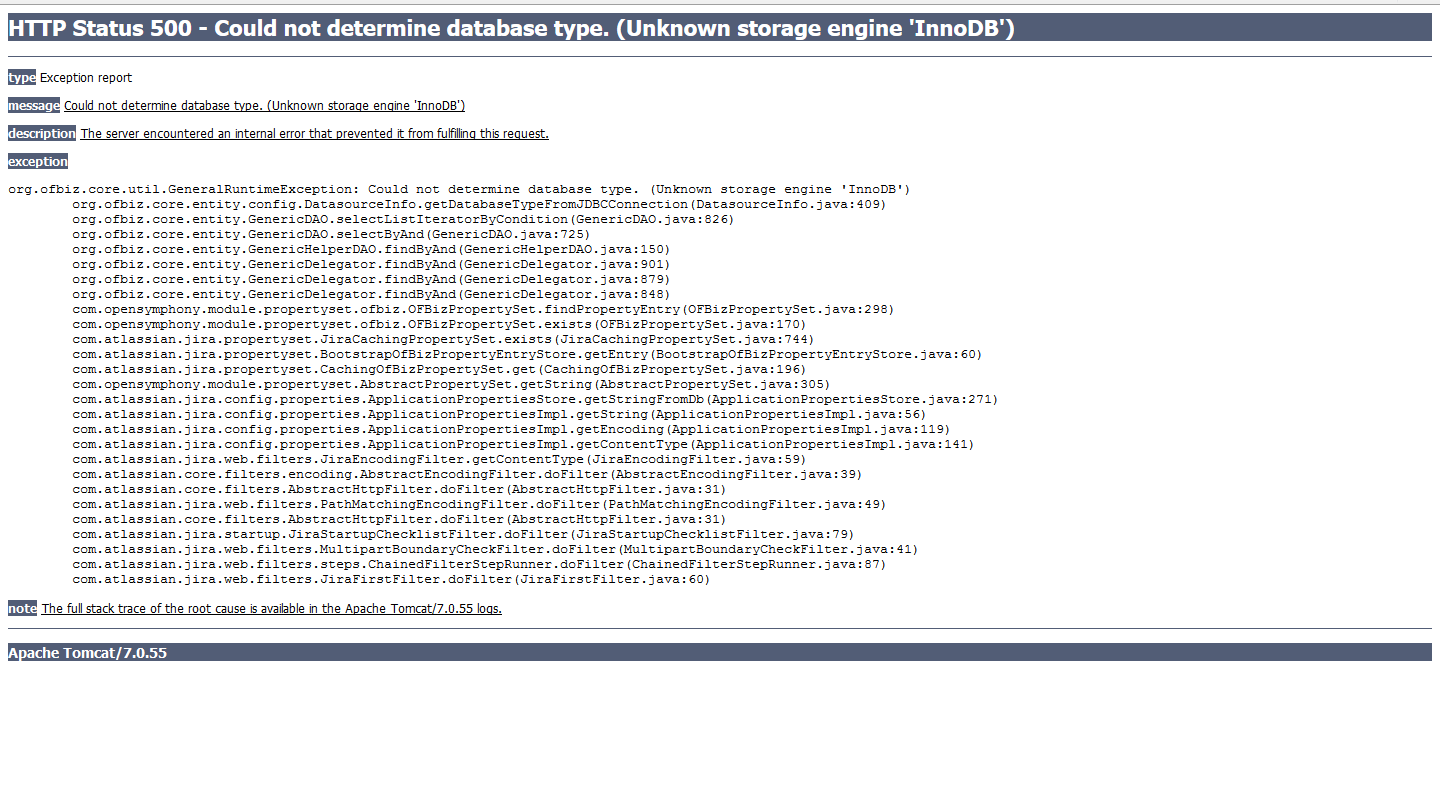

When starting up Jira the following error appears when attempting to access the application:
The following appears in the atlassian-jira.log:
org.ofbiz.core.util.GeneralRuntimeException: Could not determine database type. (Unknown storage engine 'InnoDB')
