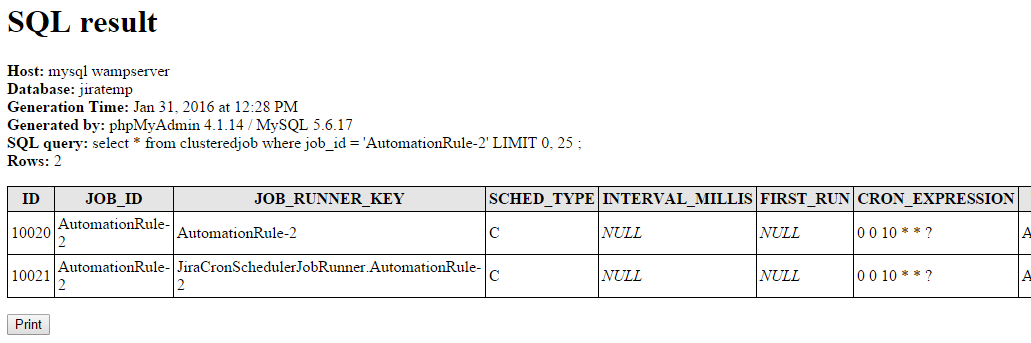

  • This SQL query identifies the entries:
select * from clusteredjob where job_id = 'AutomationRule-2';
replace AutomationRule-2 with the job_id found in the error message

  • The outcome might look like this:

The entry whose ID is older should be deleted.
In this case, it's the one that reads AutomationRule-2 (the ID is 10020).

  • Delete the problematic entry:
    delete from clusteredjob where id = 10020;
    replace 10020 with the ID found in the Diagnosis section and evaluated according to the Cause section
