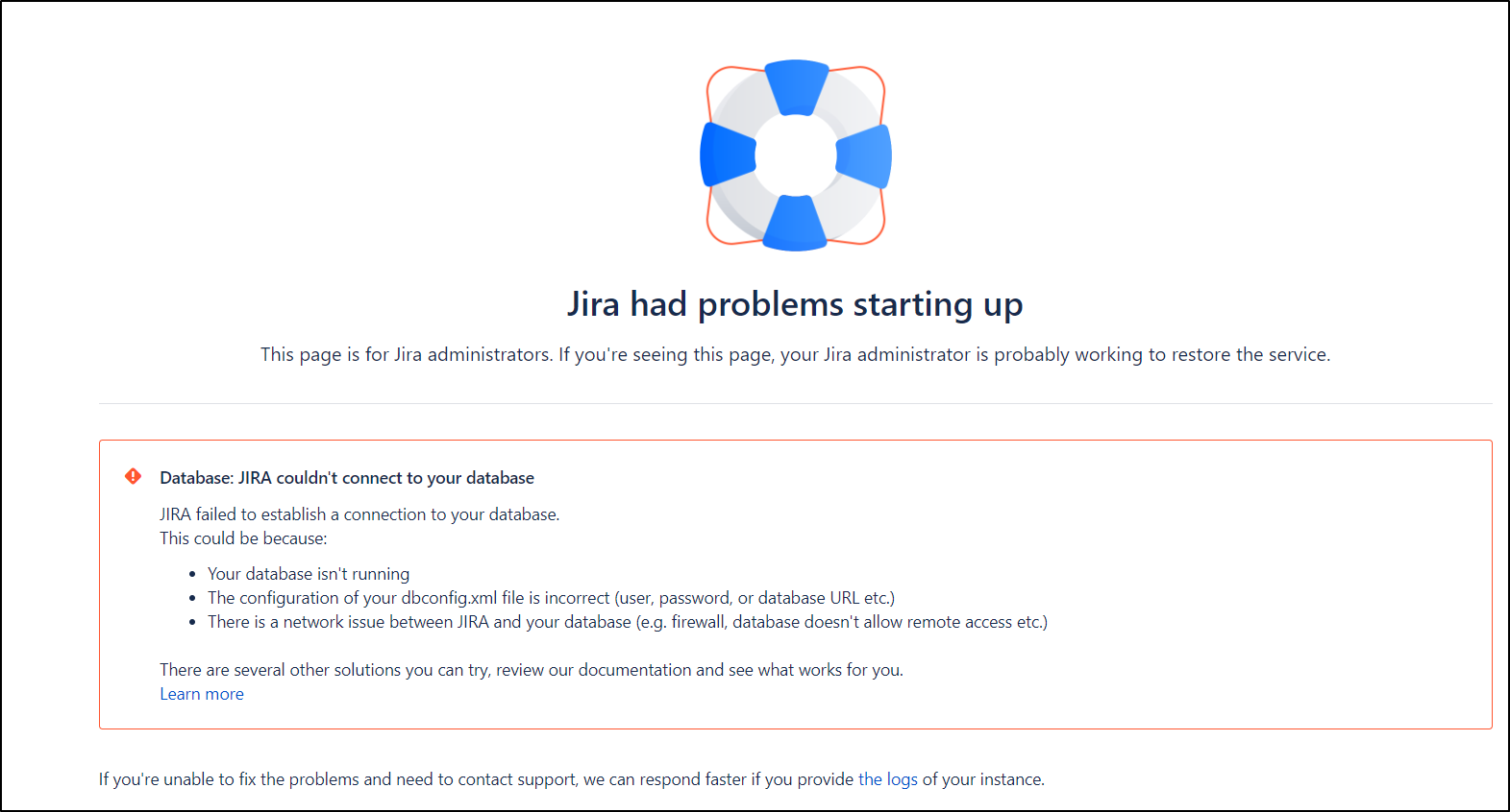

When starting up Jira, you encounter the following warning.
Reviewing the atlassian-jira.log we can see that the startup fails due to the character encoding 'UTF8mb4' being rejected by the database server.
ℹ️ The same instructions also apply if you have a different character encoding listed here.
