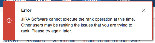

During issue ranking at the Agile board you may get the following error in the browser (UI Error):
JIRA Software cannot execute the rank operation at this time. Other users may be ranking the issues that you are trying to rank. Please try again later
Screenshot:
