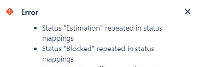

When changing the columns (adding/moving a status, adding/removing a column) of a board you get the error
"Status XXXX repeated in status mappings"

When checking the atlassian-greenhopper.log file you will find a correlating error:
2024-05-31 15:36:02,023 http-nio-49127-exec-9 url: /j9127/rest/greenhopper/1.0/rapidviewconfig/columns; user: admin INFO admin 936x94x1 21kyb7 0:0:0:0:0:0:0:1 /rest/greenhopper/1.0/rapidviewconfig/columns [web.rapid.view.RapidViewEditResource] GreenHopper REST method failed with SC = 400 - JiraCopiedBadRequestWebException 2024-05-31 15:36:02,023 http-nio-49127-exec-9 url: /j9127/rest/greenhopper/1.0/rapidviewconfig/columns; user: admin INFO admin 936x94x1 21kyb7 0:0:0:0:0:0:0:1 /rest/greenhopper/1.0/rapidviewconfig/columns [web.rapid.view.RapidViewEditResource] JiraCopiedRestErrorCollection[errorMessages=[],errors={column.3.name=Status "Estimation" repeated in status mappings, column.5.name=Status "Blocked" repeated in status mappings}]
Cause
The root cause for this is unknown, but most likely due to an issue during a project import. The board configuration tables will have the status mentioned in the error message in more than one column.
Solution
  • In the board configuration find the status with the error in any column and drag it to the Unmapped Status Column.
  • Repeat this for every status in the displayed error messages. For the example from the screenshot above this will need to be done for the statuses Blocked and Estimation.
You will receive error messages on these actions as well until all duplicated Statuses have been removed.
  • After the error message is cleared you can change the columns further without errors.
