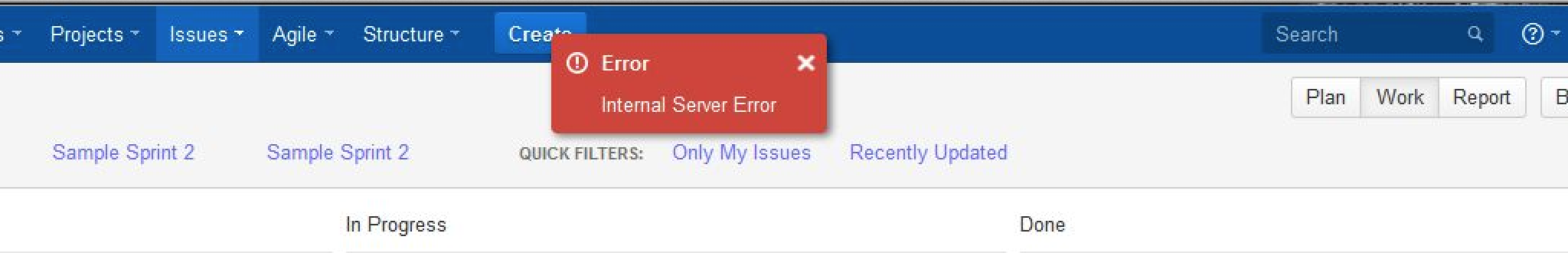

The following error shows up when accessing a Rapid board :
The following appears in the atlassian-greenhopper.log:
2015-01-26 10:23:46,461 http-bio-6312-exec-6 ERROR abcd 623x689x1 viw50s 0:0:0:0:0:0:0:1 /rest/greenhopper/1.0/rapidviewconfig/editmodel.json [common.error.jersey.ThrowableExceptionMapper] Uncaught exception thrown by REST service: null java.lang.NullPointerException at com.atlassian.greenhopper.web.rapid.view.ColumnEditRequest$StatusDetails.from(ColumnEditRequest.java:148) at com.atlassian.greenhopper.web.rapid.view.ColumnEditHelper.asStatusEntry(ColumnEditHelper.java:331) at com.atlassian.greenhopper.web.rapid.view.ColumnEditHelper.buildColumnStatusesModel(ColumnEditHelper.java:314) at com.atlassian.greenhopper.web.rapid.view.ColumnEditHelper.buildColumnEditModel(ColumnEditHelper.java:186) at com.atlassian.greenhopper.web.rapid.view.RapidViewEditHelper.getEditModel(RapidViewEditHelper.java:147) at com.atlassian.greenhopper.web.rapid.view.RapidViewEditResource$8.call(RapidViewEditResource.java:219) at com.atlassian.greenhopper.web.rapid.view.RapidViewEditResource$8.call(RapidViewEditResource.java:212) at com.atlassian.greenhopper.web.util.RestCall.response(RestCall.java:42) at com.atlassian.greenhopper.web.AbstractResource.createResponse(AbstractResource.java:100) at com.atlassian.greenhopper.web.AbstractResource.response(AbstractResource.java:81) at com.atlassian.greenhopper.web.rapid.view.RapidViewEditResource.getEditModel(RapidViewEditResource.java:211) <+3> (NativeMethodAccessorImpl.java:57) (DelegatingMethodAccessorImpl.java:43) at java.lang.reflect.Method.invoke(Method.java:606) <+19> (DispatchProviderHelper.java:234) (DispatchProviderHelper.java:100) (DefaultMethodInvocation.java:61) (ExpandInterceptor.java:38) (DefaultMethodInvocation.java:61) (DispatchProviderHelper.java:132) (DispatchProviderHelper.java:230) (ResourceJavaMethodDispatcher.java:75) (HttpMethodRule.java:288) (RightHandPathRule.java:147) (ResourceClassRule.java:108) (RightHandPathRule.java:147) (RootResourceClassesRule.java:84) (WebApplicationImpl.java:1469) (WebApplicationImpl.java:1400) (WebApplicationImpl.java:1349) (WebApplicationImpl.java:1339) (WebComponent.java:416) (ServletContainer.java:537)

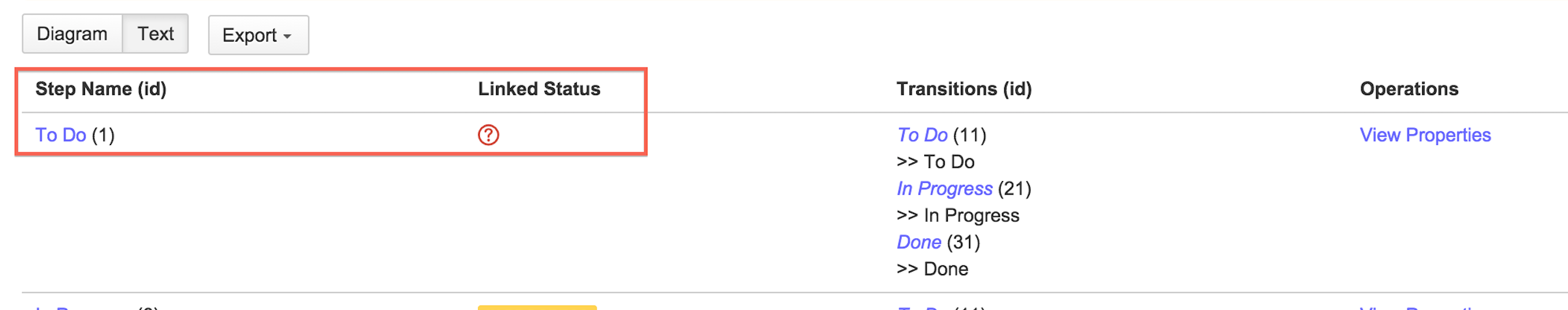

There are some workflows containing steps that do not have a linked status.

      4. One of the workflow step would be showing up like this :

  2. Restore the Linked Status by editing the workflow
    Click Edit button under that Step Operations to re-link the Linked Status
    This can only be done when the workflow is not active. To workaround this, create a copy of the active workflow and edit the Linked Status there.
