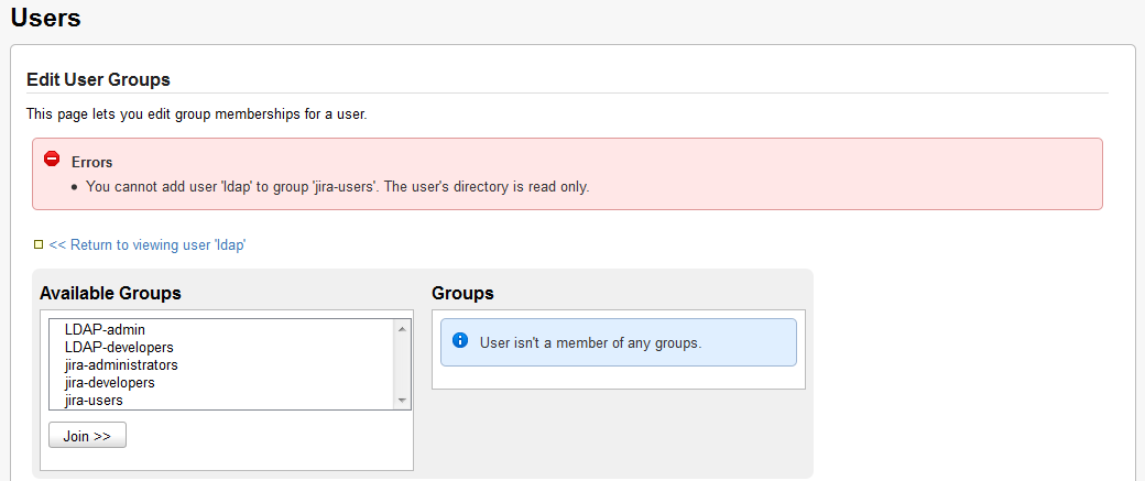

You have configured an internal directory and an LDAP directory with the permission "Read Only, with Local Groups" where you have configured the default group membership to be "jira-users". Configuration was successful and synchronization was without any problem. When you try to login as an LDAP user, it fails with the error "You do not have a permission to log in. If you think this is incorrect, please contact your JIRA administrators." When you try to associate the user with the jira-users group from the UI, you are faced with the error "You cannot add user 'xxxx' to group 'xxxxxx'. The user's directory is read only."
