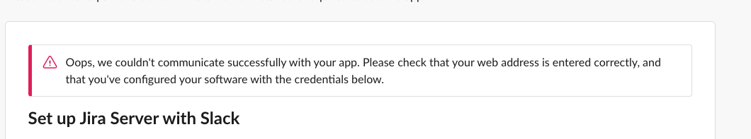

Upon installing the JIRA Server for slack (official) plugin and trying to have Slack to connect to the target Jira instance, an error is report by Slack that it can’t reach the Jira instance and report the below error message:

    • Jira is able to reach to Slack, but Slack is not able to communicate with Jira and giving the above error.
