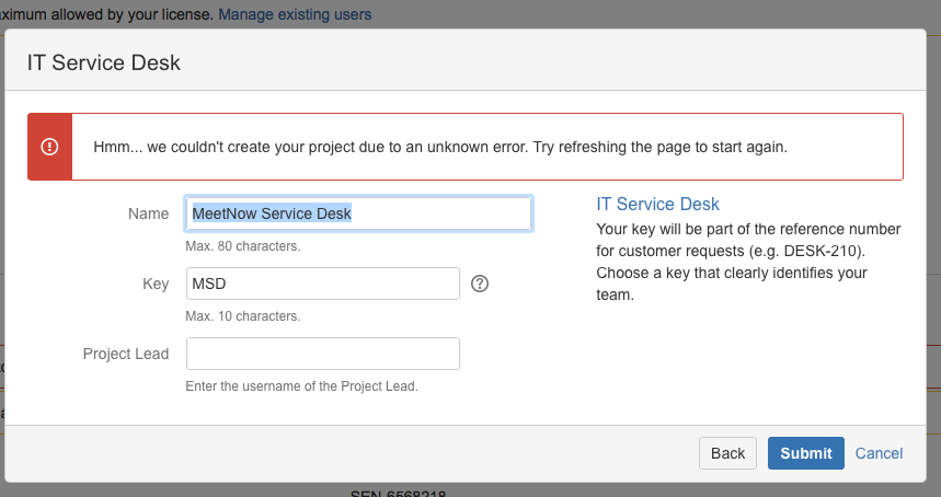

Users are unable to create a project and the following error is thrown:
hmm... we couldn't create your project due to an unknown error. Try refreshing the page to start again
IT Service Desk
