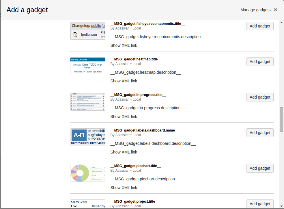

Gadget titles showing as __MSG_gadget.xxxxxxx, __MSG_gadget.activity., __MSG_gadget.filter, _MSG_gadget.project.title_ and so on, as per the example below:
For example:
Add gadget dialog in Jira showing all gadgets with titles like _MSG_gadget.project.title_ or similar
