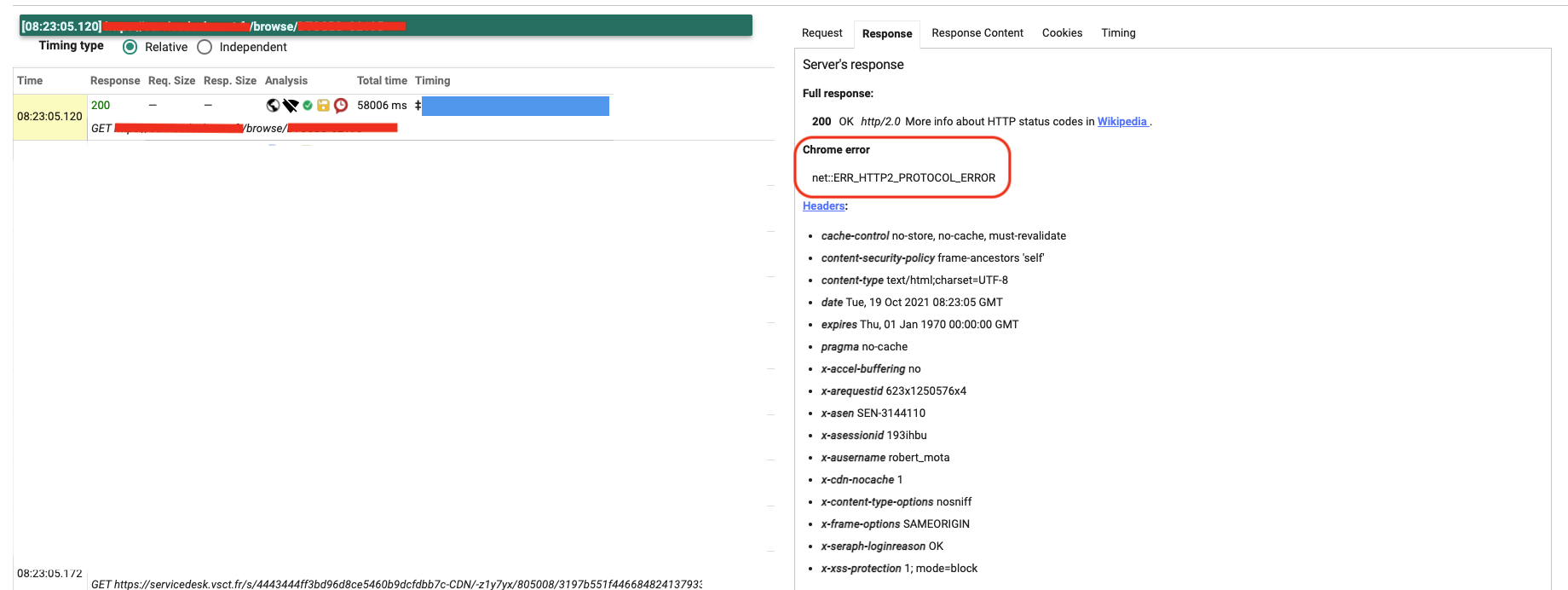

  • When collecting a HAR file while replicating the issue, some HTTP requests will show a slow loading time (about 60 seconds), along with a 200 response code and the error ERR_HTTP2_PROTOCOL_ERROR:
