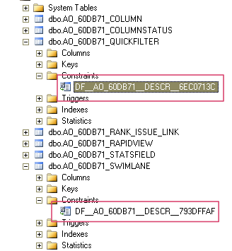

The solution is to shutdown JIRA and remove all constraints from the GreenHopper tables.
  1. Shutdown JIRA.
  2. Open the JIRA database in SQL Server Management Studio.
  3. Open the AO_60DB71_QUICKFILTER table and delete any constraints.
  4. Open the AO_60DB71_SWIMLANE table and delete any constraints.
  5. Restart JIRA.
