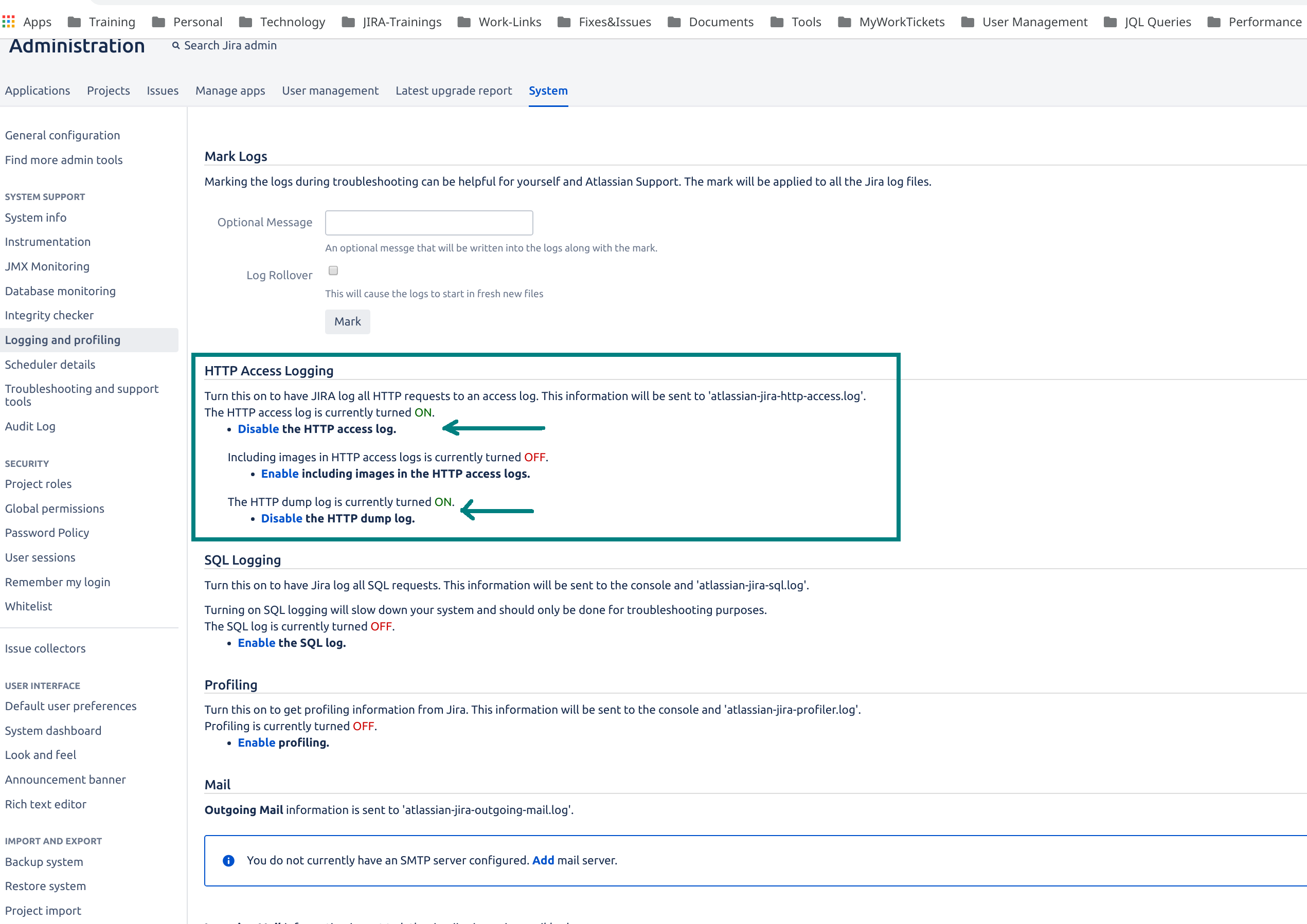

  • Need to enable extra logging in Jira to diagnose the issue:
    • Enable Jira HTTP access logs from Jira's logging and profiling page.
    • Enable the HTTP dump logs.

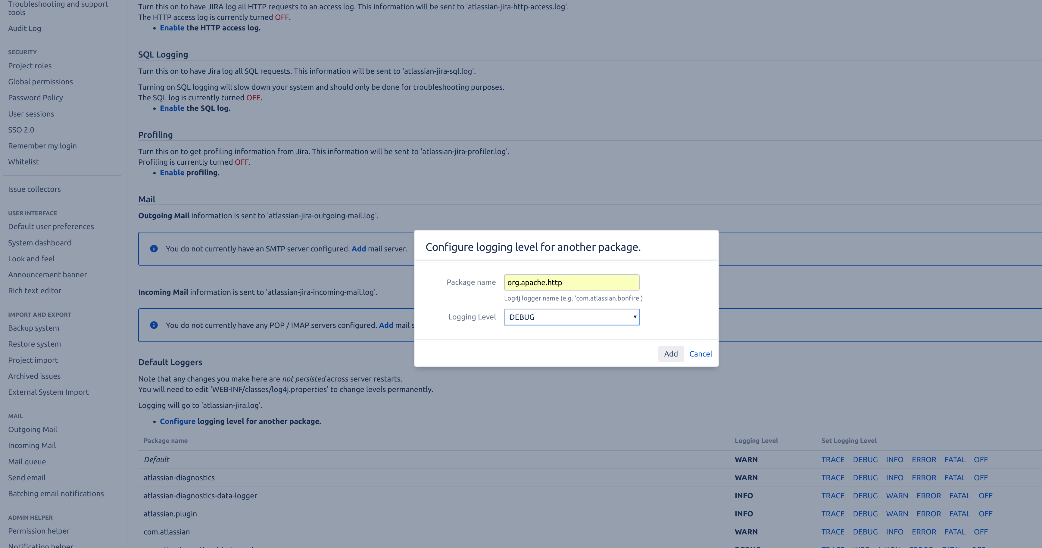

    • In the same page, under Default Loggers click Configure please add the package org.apache.http and set the log level to DEBUG.
